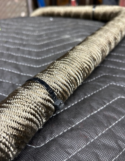

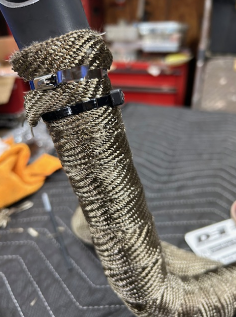

JoeM 9,322 #1 Posted March 20, 2024 The other day I was wrapping exhaust and used a trick to help temporarily hold the wrap in place until I installed the stainless ties. I usually work by my self and it allows me a third hand and the ability to regroup a points along the way. I use regular zip ties to hold the wrap and then clip them off when done. 8 2 Share this post Link to post Share on other sites
ebinmaine 75,779 #2 Posted March 20, 2024 Excellent idea. Third hands come in handy Every once in awhile I remember to do something like this. Usually while using the zip ties to gather wiring harnesses up for neatness and safety. 2 Share this post Link to post Share on other sites
