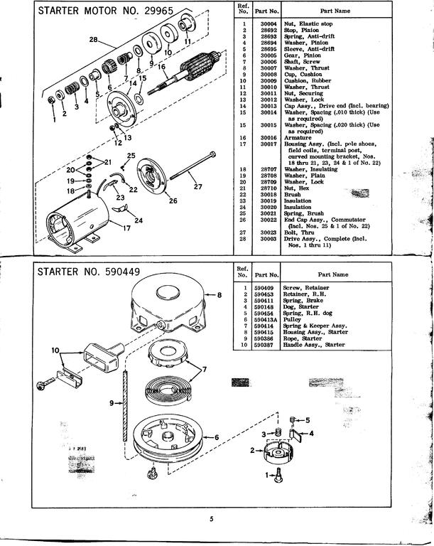

Keaton 466 #1 Posted March 20, 2024 sorry that I keep bothering you guys about this R32 lawn ranger but the recoil tooth will not come out I am not Shure what to do, I can not find a name anywhere on there I took it apart and looked still nothing and the internet had nothing on it so anything helps so I can get this fixed and hopefully running, thanks for the help- Keaton Share this post Link to post Share on other sites

pfrederi 19,491 #3 Posted March 20, 2024 (edited) This manual should be a help with your engine Tecumseh used the same recoil for a long time I would imagine part numbers on here work for yours Edited March 20, 2024 by pfrederi Share this post Link to post Share on other sites
ri702bill 10,972 #4 Posted March 20, 2024 and, this one...... Tecumseh_replacement_parts.pdf Share this post Link to post Share on other sites
