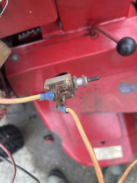

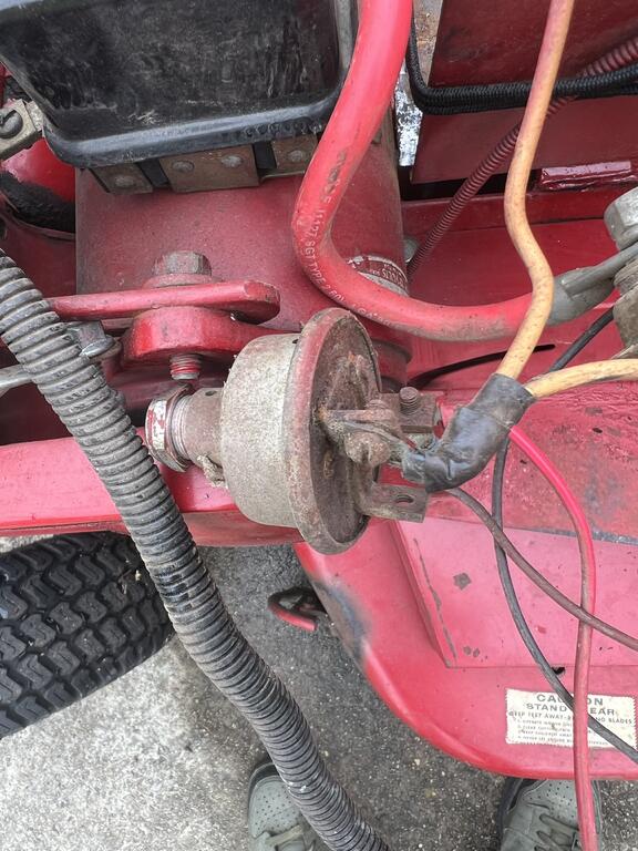

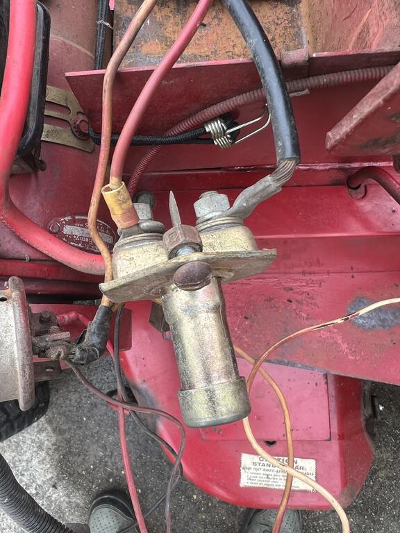

MTB Mike 1 #1 Posted March 17, 2024 We have a 1964 1054 that we are trying to get running again. We need to replace the ignition switch, the starter and the light switch, along with the plastic handle that goes on the throttle and choke levers. Where would we be able to locate these parts? 1 Share this post Link to post Share on other sites
elcamino/wheelhorse 9,362 #2 Posted March 17, 2024 Try K&B in the vendor section , he maybe able to help you. 1 Share this post Link to post Share on other sites
squonk 44,746 #3 Posted March 17, 2024 Depending on how "Original" you want to keep it. Key switch is a simple on/off Cole Hersee 95597 Light switch Napa PP6020 Starter button Napa ST 6 Tractor supply SKU 236643 3 Share this post Link to post Share on other sites
