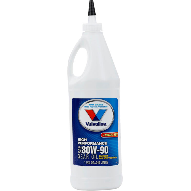

Racinbob 12,294 #2 Posted March 17, 2024 I've used this in all my 3/4 and 6/8 speeds for decades. 2 Share this post Link to post Share on other sites
ebinmaine 74,971 #3 Posted March 17, 2024 I use whatever is the least expensive 75, 80, 90, up to 140 that's available. GL4 or GL5 shouldn't matter because there are no brass parts in these Transmissions. The only issue that I will point out is, when it's real cold, Trina has a six-speed that is pretty temperamental. It has 85W140. That'll be changed for a lower viscosity. I use the same thing in my 8-speed c160 and have no issues. Share this post Link to post Share on other sites
bo dawg 536 #4 Posted March 17, 2024 yea I always thought the 90-140 was too heavy. I was thinking last time I changed one I used the 80-90 stuff. 1 Share this post Link to post Share on other sites
ebinmaine 74,971 #5 Posted March 17, 2024 3 minutes ago, bo dawg said: yea I always thought the 90-140 was too heavy. I was thinking last time I changed one I used the 80-90 stuff. On Trina's lighter tractor it makes the machine act like it's in low low unless it's warmed up a little bit. I figure the reason it seems okay in my bigger heavier machine is that the extra weight of the tractor compensates for whatever push the oil is trying to give. 2 Share this post Link to post Share on other sites
bo dawg 536 #6 Posted March 17, 2024 I had the Lucas 80-90 and used that. 1 Share this post Link to post Share on other sites
