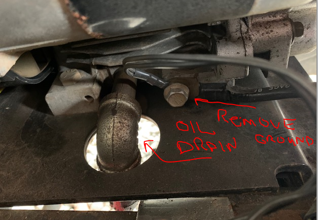

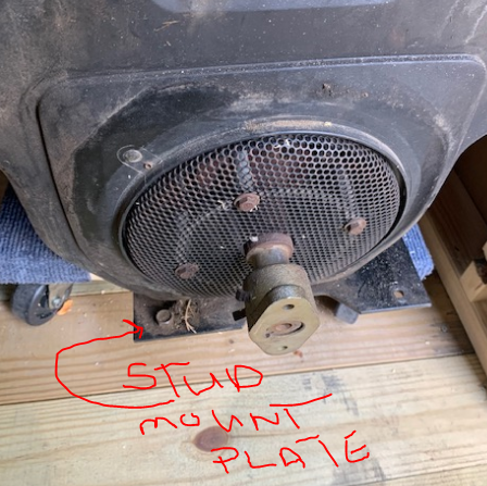

JoeM 9,619 #3 Posted March 9, 2024 Not to hard I have had several out, it is about an hours work. Some things are obvious but I will try to step you through it. If equipped, remove the mower and mule drive. Disconnect the battery. Remove the side panels, hood and side support brackets The engine has a plug on the right side that isolates it from the machine. and there is a plug for the clutch, that will need disconnected also. Disconnect the drive shaft at the engine. The engine mounts to a square plate that bolts to the frame, I pull the engine with the plate. The bolt on the left side near the operator is a stud that has a nut underneath. The three remaining are through bolts. When hoisting the engine it needs to swing forward and up to allow the drive shaft to clear the firewall. Once out remember the oil drain tube goes through the mounting plate and sticks out. I will set the unit down on an old tire or a couple blocks. Going from memory, hope I did not miss anything. 2 2 Share this post Link to post Share on other sites
