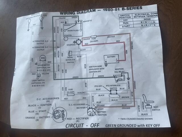

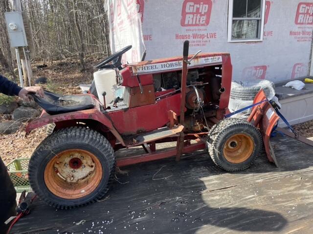

AHS 1,642 #1 Posted March 5, 2024 Just so you have an idea of what your looking at here. It’s got no fire, and it wont crank over by key. It uses ground to shut it off. Im 95% sure that I have the right wiring diagram. What is the part number for the key switch? Im fairly certain the kohler K series key switch’s would work. Share this post Link to post Share on other sites
953 nut 64,646 #2 Posted March 5, 2024 You do have the correct wiring diagram. The ignition switch you need is a 103-990, see attachment below. 1 Share this post Link to post Share on other sites
