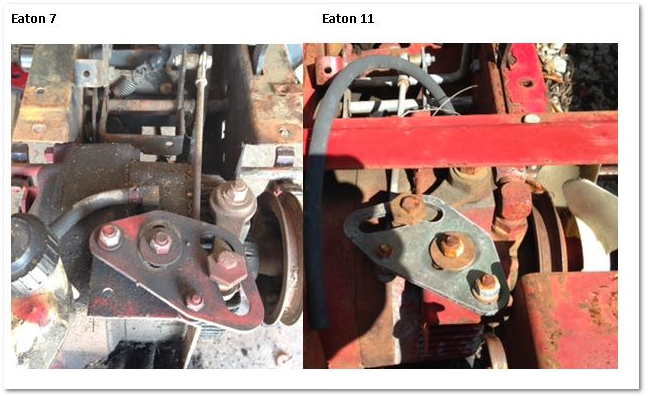

JoeM 9,048 #7 Posted February 26, 2024 Might want to consider getting an 1100 trans complete and install. Probably the best option as far as reliability and cost. The 1100 trans axle uses the sump for the trans fluid. The control gets flipped around and will work the same 1 Share this post Link to post Share on other sites
kpinnc 15,948 #8 Posted February 26, 2024 (edited) 8 minutes ago, JoeM said: Might want to consider getting an 1100 trans complete and install. Definitely a good idea. You'll gain hydraulic lift, and the 1100 has three times the output torque of the 700! Whatever you do, be sure to keep the cooling fins clean. A cool hydro is happier. Heat is almost as bad as dirt on these hydros. Clean and cool will preserve them. Edited February 26, 2024 by kpinnc 1 Share this post Link to post Share on other sites

Handy Don 14,878 #10 Posted February 26, 2024 (edited) 11 hours ago, 87 416-8 horse said: All the balls are free and move. Per the service manual, the balls are mated to the sockets and once hydro has been run, they should not be interchanged due to tight tolerances and “wear in”. Be sure to keep the oil expansion reservoir attached and filled to spec. The “innards” of the 700 are smaller than the 1100 and hence it is less capable of transmitting power. It is a perfectly fine unit for mowing and blowing motion, where the engine directly powers the implement, but it isn’t designed for plowing soil or snow. If you do go to an 11, you’ll need to link the charge pump output to the filter input unless you also add the hydraulic cylinder and control plumbing! Edited February 26, 2024 by Handy Don 1 Share this post Link to post Share on other sites

kpinnc 15,948 #13 Posted February 26, 2024 (edited) Many of these old tractors have swapped hood and fenders. Sometimes a model isn't what the hood says it is. Easiest way to be sure is that of the oil filter faces the rear, it's an Eaton 1100. Edited February 26, 2024 by kpinnc 2 1 Share this post Link to post Share on other sites
