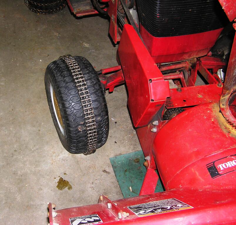

Wayne0 1,358 #1 Posted February 17, 2024 (edited) Just before I got "retired", I grabbed a couple lengths of double #50 roller chain with this in mind. It was getting scrapped anyway as everything is belt drive now. Kinda' wish I grabbed some #40 for Ol' Rusty. You guys with chain, what do you run for pressure? Right now I've got 10psi. Edited February 17, 2024 by Wayne0 5 1 Share this post Link to post Share on other sites
pfrederi 18,982 #2 Posted February 17, 2024 (edited) I get the chain wedged on with 0 pressure then put it up to 12-14. Haven't lost one yet in several years. I do have one tire I have to watch she has a very slow leak. I am running the older narrower 5.50s Wish I had chain like that!! Edited February 17, 2024 by pfrederi 4 Share this post Link to post Share on other sites
Wayne0 1,358 #3 Posted February 17, 2024 Haven't had the chance to run them yet, so we'll see. Share this post Link to post Share on other sites
ebinmaine 74,620 #4 Posted February 18, 2024 Like that double wide chain! Share this post Link to post Share on other sites
midpack 1,062 #5 Posted February 18, 2024 I'm interested to hear how double wide chain works, I've had single #40 for years with great success 2 Share this post Link to post Share on other sites
