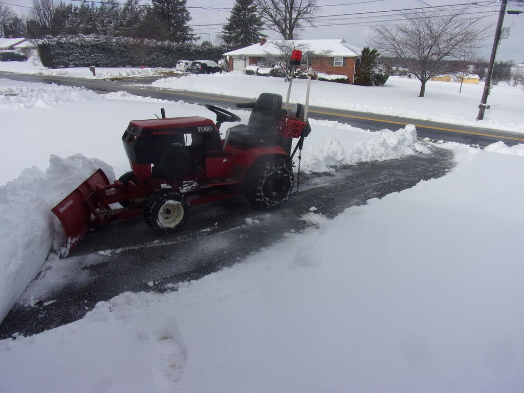

leabassett@sbcglobal.net 156 #1 Posted February 14, 2024 Well we got about 6" of heavy wet snow today and my 312-8 did well. Only had to back up and go at it a few times. My only problem was trying to steer. Do the small front wheel weights Make much of a difference? Share this post Link to post Share on other sites

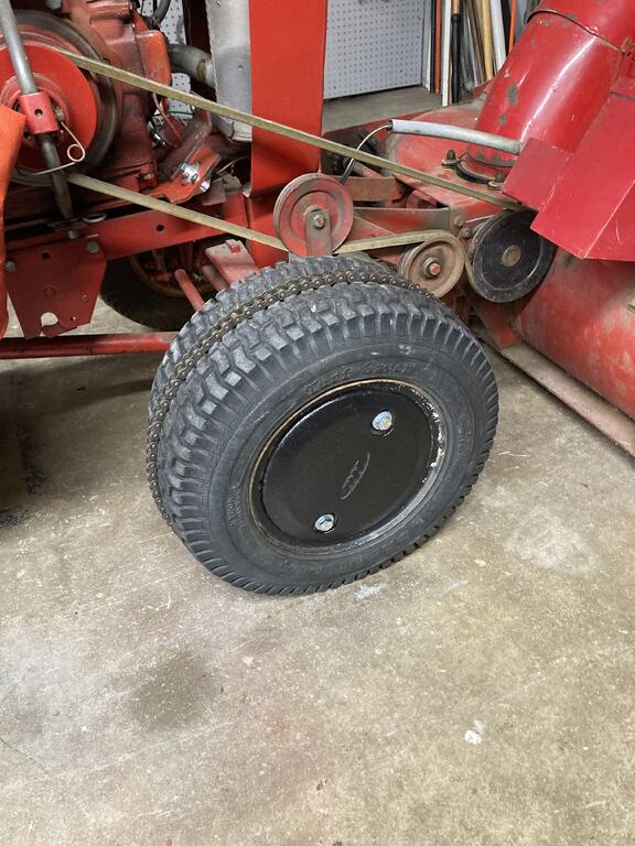

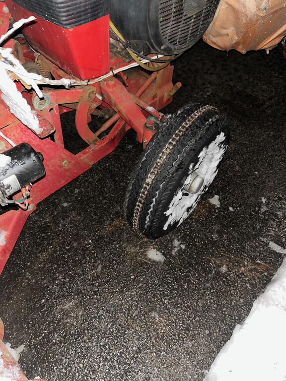

wallfish 18,788 #6 Posted February 14, 2024 I went skinnier tires and roller chain. Makes a huge difference. Added weight would help even more but the 520 does well without it 5 Share this post Link to post Share on other sites

pfrederi 19,270 #13 Posted February 14, 2024 Narrower tires with roller chain, wheel weights, and hang more weight on the front of the tractor 1 Share this post Link to post Share on other sites

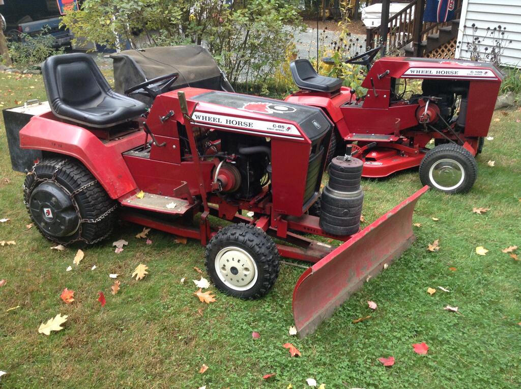

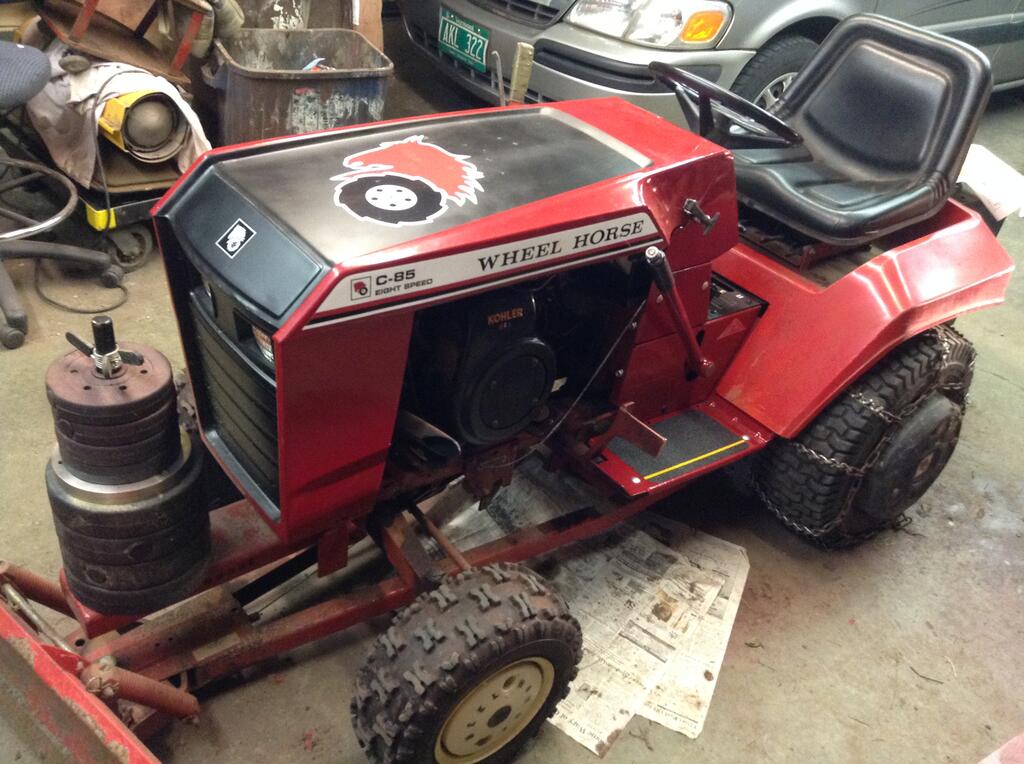

C-85 778 #15 Posted February 15, 2024 I attempted to solve this by adding lots of front wheel weights, a weight platform that's independent of the plow, and changed the turf tires to Sno Hog tires and it's better, but can still slip some. If I had to do this again I would have tried the roller chain trick, that seems like a very good option! C-85 2 Share this post Link to post Share on other sites
ebinmaine 75,757 #16 Posted February 15, 2024 6 minutes ago, C-85 said: . If I had to do this again I would have tried the roller chain trick, that seems like a very good option! Roller chains are good. But weight is still the key. At some point I'll be swapping the front of my Automatic tractor to a set of 5 lug trailer hubs. When that happens I'll space the wheels far enough from the spindles to use traditional full wrap chains. Share this post Link to post Share on other sites
