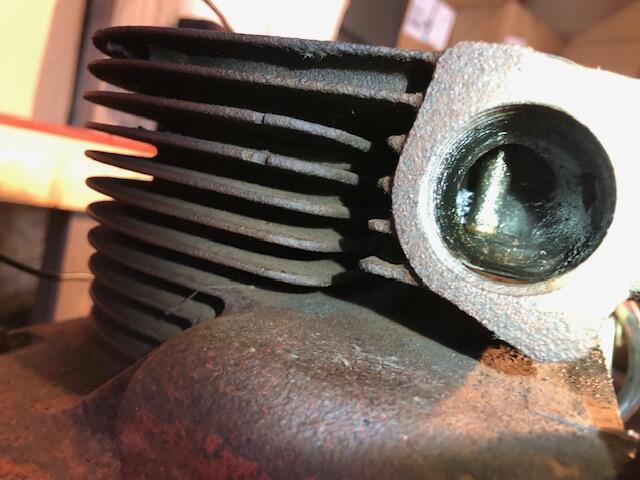

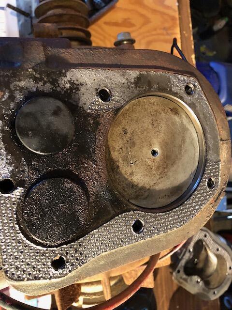

Sailman 1,307 #57 Posted February 13, 2024 Good news I think but baffled.....I took @WHX?? advice and took the head off before the oil pan. I had put some marvel mystery oil in the spark plug hole to prep the piston for removal in case it was stuck. So what i found was a stuck exhaust valve. See pics below. Piston, tappets and intake valve all move fine by rotating flywheel counter clockwise. I put some Kroil on the valve stem and gently tapped with dead blow hammer but no movement. Thinking of getting in there tomorrow with carb cleaner and brass brush to try to clean it up. Any suggestions? Now for the baffling part....I had rotated the flywheel before disassembly and I SWEAR it did not move. That is why I assumed it had a broken rod like the K-161 in my 701. It did make a sucking sound which I guess was the intake valve? So I pull the head off and lo and behold...the piston move up and down just fine. I'm confused! The piston has std stamped on it and cylinder looks clean. Is it supposed to have that small hole in it. Any and all comments are welcome. I really appreciate you experienced guys helping me out here. 3 Share this post Link to post Share on other sites
WHX?? 58,345 #58 Posted February 13, 2024 Keep at that valve just what you been doing. It will free up. You can pull the valves then for better cleaning. The hole in the piston is normal centering mark from when it was machined. Move the piston down and get us pics of the bore. You may not even have to pull the piston. I would now pull the pan for inspection and further cleaning. 2 1 Share this post Link to post Share on other sites
Achto 32,916 #59 Posted February 13, 2024 (edited) 50 minutes ago, Sailman said: So I pull the head off and lo and behold...the piston move up and down just fine 13 minutes ago, WHX?? said: ove the piston down and get us pics of the bore. You may not even have to pull the piston. @Sailman did you clean the top of the piston before taking the picture? Reason that I ask is because the top of the piston looks awfully clean. When they are this clean when you pull the head off this indicates piston wash (piston being washed off by engine oil) Indication of bad rings. Edited February 14, 2024 by Achto 2 1 Share this post Link to post Share on other sites
WHX?? 58,345 #60 Posted February 14, 2024 (edited) My next suggestion Dan after a look at the bore is to have it measured. By the way dingle berries came in for my hone job. Edited February 14, 2024 by WHX?? 1 1 Share this post Link to post Share on other sites
Sailman 1,307 #61 Posted February 14, 2024 (edited) 12 hours ago, Achto said: @Sailman did you clean the top of the piston before taking the picture? Reason that I ask is because the top of the piston looks awfully clean. When they are this clean when you pull the head off this indicates piston wash (piston being washed off by engine oil) Indication of bad rings. Yes I did clean the piston so I could read the markings...STD. Will take pics of the bore tomorrow. 12 hours ago, WHX?? said: My next suggestion Dan after a look at the bore is to have it measured. Will do. I have a set of Central Tool co telescoping bore gauges coming from fleabay. Picked up a set of HF micrometers today. Going by a machine shop to have them calibrated. The 1 inch gauge seems correct by measuring with caliper and zeroing out the micrometer but the 2 inch gauge seems off by .002 to .005. I know they are not the best but if they calibrate ok should serve my purpose. Edited February 14, 2024 by Sailman 1 Share this post Link to post Share on other sites

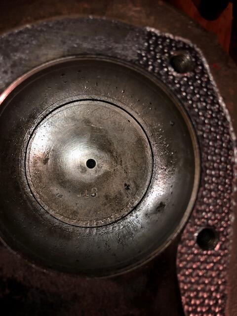

Sailman 1,307 #63 Posted February 15, 2024 Here is picture of the bore with piston all the way down. Looks smooth. No dings or scratches that I can see. Still trying to get the valve to budge. No movement yet. Share this post Link to post Share on other sites

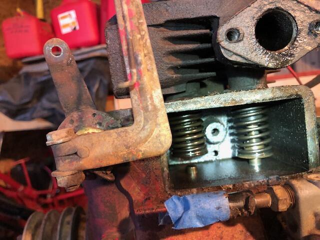

953 nut 70,233 #64 Posted February 15, 2024 9 minutes ago, Sailman said: Still trying to get the valve to budge. Try some gentle upward pressure on the valve and spring using a small pry bar of some sort. Don't hit the valve head too much for fear of bending the stem. May want to remove the build-up on the valve stem before doing too much. 1 1 Share this post Link to post Share on other sites
RED-Z06 2,720 #65 Posted February 15, 2024 Ive had luck putting vice grips ad gently as possible around the head, and heat the guide/stem, and just give it some gently twist, see if it will budge...once it moves in any direction you're home free. 2 1 Share this post Link to post Share on other sites
Sailman 1,307 #66 Posted February 15, 2024 20 minutes ago, 953 nut said: Try some gentle upward pressure on the valve and spring using a small pry bar of some sort. Don't hit the valve head too much for fear of bending the stem. May want to remove the build-up on the valve stem before doing too much. That is a good suggestion. Will try that tomorrow. I have used carb cleaner on it and the stem is pretty clean. Still seeping the Kroil every day. Pretty careful with the tap tapping on the valve head. Hard to believe how stuck it is. 2 1 Share this post Link to post Share on other sites
Sailman 1,307 #67 Posted February 15, 2024 (edited) 18 minutes ago, RED-Z06 said: Ive had luck putting vice grips ad gently as possible around the head, and heat the guide/stem, and just give it some gently twist, see if it will budge...once it moves in any direction you're home free. Might try that too. I have a rubber strap wrench....might be less chance of damaging the valve head. Thanks. Edited February 15, 2024 by Sailman 2 Share this post Link to post Share on other sites
WHX?? 58,345 #68 Posted February 15, 2024 Patience is your best friend Saildude on a stuck valve. Something which I have none of. 2 Share this post Link to post Share on other sites
Sailman 1,307 #69 Posted February 16, 2024 Whooo Hooo! Patience, Kroil, tapping with dead blow, carb cleaner and rotating the tappet against the valve....has paid off. Stuck valve is free. Also stuck choke on carb finally loosened up too. At this point I am going to check measurement in the bore and if it is good I don't see any reason to pull the oil pan. My goal was not to have to do a total rebuild so if all works ok might just go with that. Not sure if I should pull the valves and clean and lap or clean it as best I can and put it back together. It will not be a heavy used worker, just a fun tractor for grand-kids to drive occasionally. Will true the head, new points, have rebuilt the carburetor and will use new gaskets all around. Thoughts? IMG_4235.MOV 2 Share this post Link to post Share on other sites

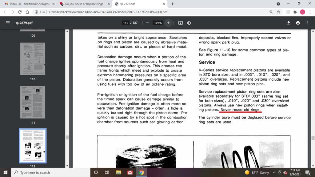

WHX?? 58,345 #70 Posted February 16, 2024 (edited) 10 hours ago, Sailman said: At this point I am going to check measurement in the bore and if it is good I don't see any reason to pull the oil pan. Sounds like a good plan. The only reason now to pull it would be for cleaning but oil additives and frequent changes would help that. I would still pull the valves for cleaning & lapping. Just so you know pulling the piston automatically requires a hone job and new rings. If the rod was not installed wrong on mine I would not have pulled the piston. your measurements reveal no out of spec taper or round. Edited February 16, 2024 by WHX?? 1 1 Share this post Link to post Share on other sites
RED-Z06 2,720 #71 Posted February 16, 2024 3 hours ago, WHX?? said: Sounds like a good plan. The only reason now to pull it would be for cleaning but oil additives and frequent changes would help that. I would still pull the valves for cleaning & lapping. Just so you know pulling the piston automatically requires a hone job and new rings. If the rod was not installed wrong on mine I would not have pulled the piston. your measurements reveal no out of spec taper or round. Ive never heard anyone say pulling piston out requires new rings and hone out? Rings spin on the piston while running, whats the logic to having to replace rings? 1 1 Share this post Link to post Share on other sites
WHX?? 58,345 #72 Posted February 16, 2024 13 minutes ago, RED-Z06 said: pulling piston out requires new rings and hone out? I'll let @Achto elaborate but it comes from building Harley motors in that if the piston leaves the jug it gets new rings. Something about they won't reseat I think... worn to the shape of the bore? I don't subscribe to the theory that rings spin on the piston. If they do why bother to stagger end gaps? 1 1 Share this post Link to post Share on other sites
Achto 32,916 #73 Posted February 16, 2024 47 minutes ago, RED-Z06 said: Ive never heard anyone say pulling piston out requires new rings and hone out? Rings spin on the piston while running, whats the logic to having to replace rings? Piston rings will rotate some unless they are pinned as in the case with many 2 stroke engines. Break in or where in needs to occur in order for the rings to seat properly. Once you remove the rings from the cylinder they will never seat properly again and you will have an oil burner that has a compression loss. Then of course there is the recommendations from page 11.9 in the Kohler manual. 1 3 Share this post Link to post Share on other sites
