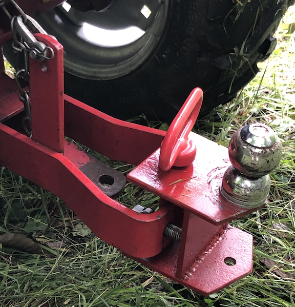

Handy Don 15,217 #9 Posted February 5, 2024 (edited) For the sleeve hitch users, this wasn’t hard to make... Trailer tongue weight keeps it down. We use it to move over-the-road utility trailers around for easier loading and parking. We flip it “tab hitch up” for the garden trailer to get the hitch height needed for the trailer to run level. Of course the drawbar is still usable as well, with the hitch fully lifted and a low tongue on the pulled implement. Edited February 5, 2024 by Handy Don 4 Share this post Link to post Share on other sites
