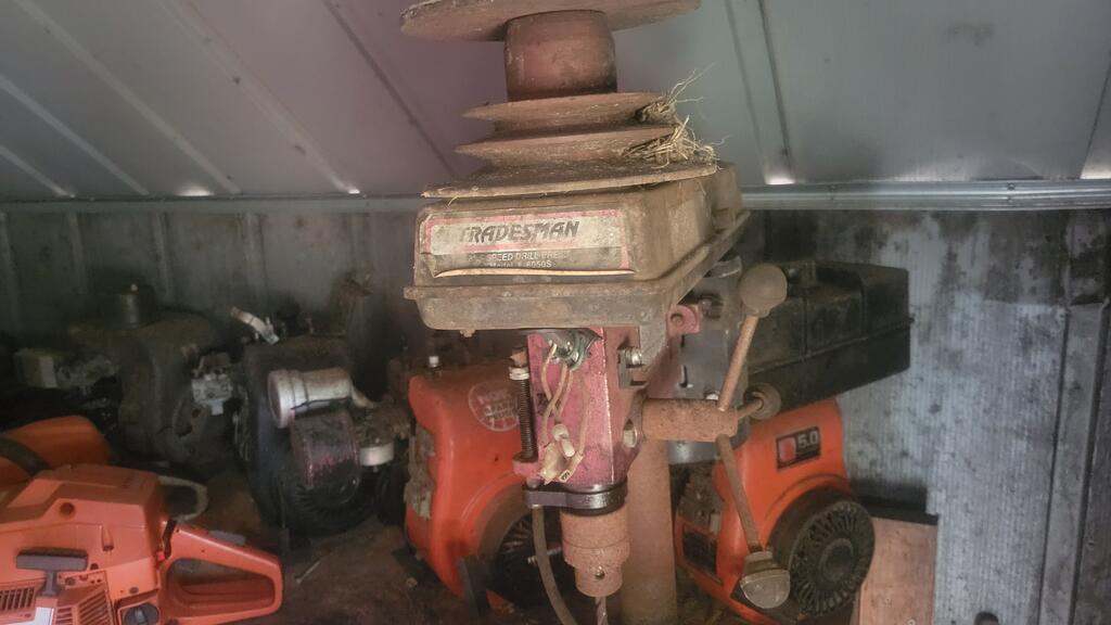

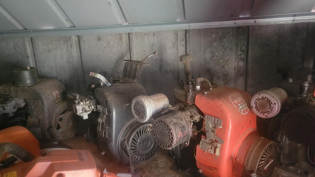

RED-Z06 2,681 #6 Posted February 5, 2024 H has breakerless ignition, and given HH points...thats enough to steer me to an H. I have a few H60s, HH60s, H50, in storage...fun engines, i took the cabs off most and stuffed paper in the intakes because they all had carb problems like most tecs usually did🤣 Share this post Link to post Share on other sites

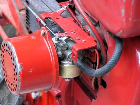

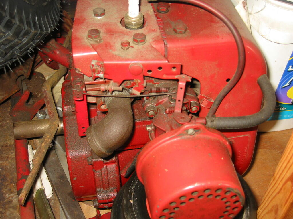

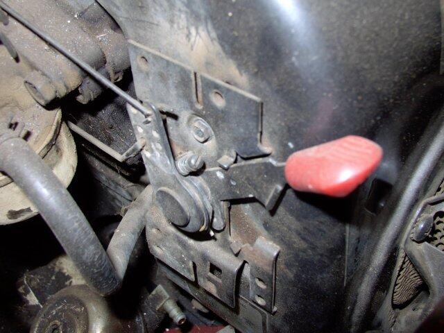

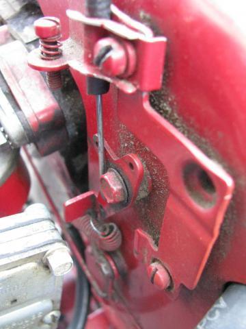

Howie 900 #15 Posted February 6, 2024 I run a HH 60 on my Lawn Ranger, have to look closely at it to tell. The surface of the aluminum blocks are smoother. Some of the aluminum blocks had the cast iron sleeves and there were some aluminum bore engines They used a variety of throttle control setups. The one on mine came of of a Gravely tiller I think. I pieced the thing together. Share this post Link to post Share on other sites
RED-Z06 2,681 #16 Posted February 6, 2024 25 minutes ago, Howie said: I run a HH 60 on my Lawn Ranger, have to look closely at it to tell. The surface of the aluminum blocks are smoother. Some of the aluminum blocks had the cast iron sleeves and there were some aluminum bore engines They used a variety of throttle control setups. The one on mine came of of a Gravely tiller I think. I pieced the thing together. The simplest was the style with the tall governor arm, linkage to the carb, and the short throttle linkage and spring...but they had alot of options 1 Share this post Link to post Share on other sites
