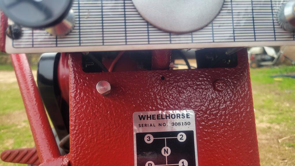

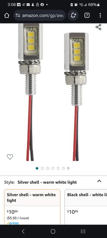

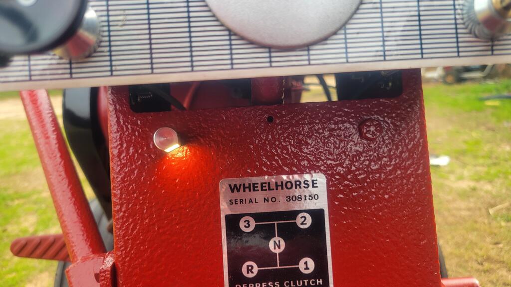

RED-Z06 2,716 #1 Posted February 3, 2024 I grabbed a few led license plate bolt lights off the 'zon...they are 1/4-20 threaded, so i removed one of my hood stand bolts, slipped 2 wires through, put the nut on the back, snugged it down, ran a ground; and ran the 12v wire to the switched accessory terminal on the switch. Its a warm 4300k color, not distractingly bright..and its tucked away with no additional modifications. I intend to add these to my other various tractors as well, they should thread in as dash bolts on 300/400 series. 1 6 Share this post Link to post Share on other sites
gwest_ca-(File Mod) 11,998 #2 Posted February 4, 2024 Is the 308150 serial number on a 702? I thought all 1962 models used a 62-xxxxx serial. 1 Share this post Link to post Share on other sites
RED-Z06 2,716 #3 Posted February 4, 2024 14 minutes ago, gwest_ca said: Is the 308150 serial number on a 702? I thought all 1962 models used a 62-xxxxx serial. Its a replacement decal, the original decal was about 50% missing, but yes it did have the 62- Share this post Link to post Share on other sites
