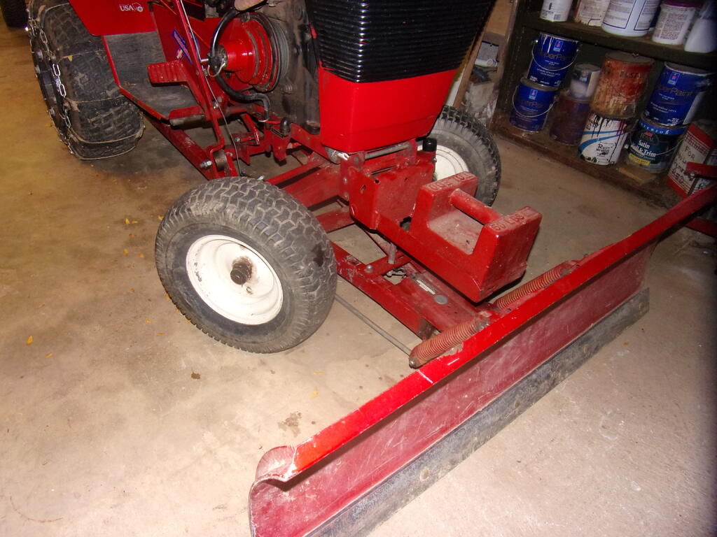

Ed Kennell 44,815 #6 Posted February 3, 2024 1 hour ago, gwest_ca said: Do you have 6" or 8" front wheels? Believe the 312's came with both. 6" allows room for the 37" 2-spindle mower deck. Very good point if you are replacing wheels. My 312 Hydro came with 6" wheels and the longer spindles. I switched it to 8" wheels and left the longer spindles to get more clearance under the front axle for the snow plow frame. I never had a 37" deck, but the 42" deck works fine. The tractor frame is not level sitting higher in the front . Share this post Link to post Share on other sites
