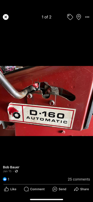

Bob Bauer 27 #1 Posted February 2, 2024 Morning, I have been wheel horse D160 and wondering if there’s some kind of adjustment for the transmission. It is super touchy to get into neutral position. It either wants to go into forward or reverse and tough to find neutral. Thanks Share this post Link to post Share on other sites
pfrederi 19,278 #2 Posted February 2, 2024 The linkage on the D series can be a challenge to get adjusted. Download this manual and look at pages 22-24 Share this post Link to post Share on other sites
Bob Bauer 27 #3 Posted February 2, 2024 4 minutes ago, pfrederi said: The linkage on the D series can be a challenge to get adjusted. Download this manual and look at pages 22-24 Thanks Share this post Link to post Share on other sites
