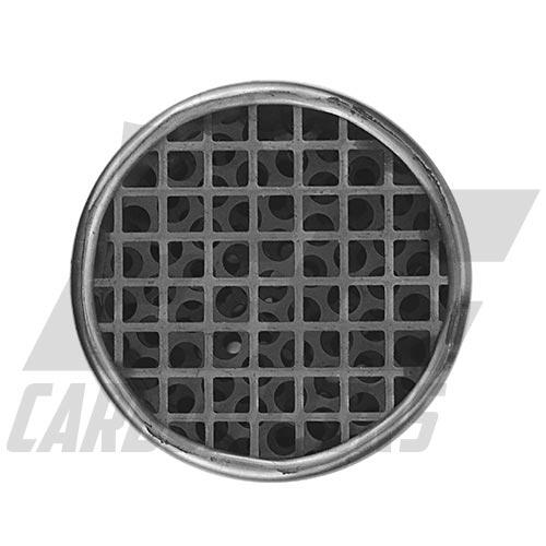

RED-Z06 2,716 #1 Posted February 1, 2024 I was clearing out a corner of the shop today and found an old RLV silencer i ran on my old Racing kart, i figured if it can flow a 200cc engine turning 8600 a K series shouldn't be a problem. The Nelson muffler is fine but i catch a sharp "crack" on the exhaust note, its annoying when you mow for a couple hours. I slid the rlv silencer (its a can with about 6 steel screens in it) on and it really takes the edge off the sound. Id probably have to make a support arm to keep it from snapping the outlet off from vibration but i thought it was cool how it did effectively help. I put it on my 27hp Vtwin and the difference there was even more pronounced. 7 Share this post Link to post Share on other sites

RED-Z06 2,716 #3 Posted February 2, 2024 21 minutes ago, ebinmaine said: Definitely takes a bit of the "blappy sharpies" off the sound doesn't it. The tone is much lower for sure, it dulls it down. Its kinda weird hearing the mechanical engine sounds over the exhaust 3 Share this post Link to post Share on other sites

RED-Z06 2,716 #8 Posted February 2, 2024 4 hours ago, ebinmaine said: That's a good point. Is that silencer a straight through design? Basically? Theres about 4 or 5 screens inside. They use this design on 420cc ohv engines that turn 9500 to 10,000 rpms, its really not restrictive, it takes the edge off 1 Share this post Link to post Share on other sites
