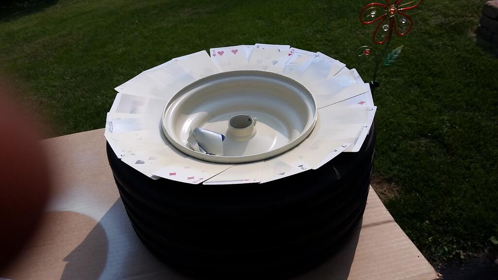

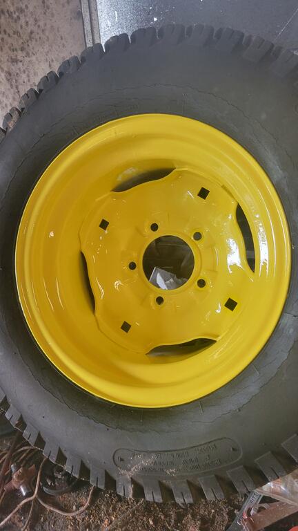

RED-Z06 2,718 #1 Posted February 1, 2024 I thought id mentioned it on here before but maybe not. If you find yourself painting wheels alot, let the air out, dont dismount the tires, they will pull off the rim a bit from deflating. Jump on Amazon and grab the cheapest playing cards you can..i usually get a 24 pack for 20 bucks or less. Then stick them down in the rim, overlapping to form a solid barrier. No taping required. You can usually use them a couple times 6 Share this post Link to post Share on other sites
kpinnc 17,692 #2 Posted February 1, 2024 (edited) Use this myself on a regular basis. Works better than anything I've tried on wheels. I usually give them a primer coat inside before mounting the tires, then this process afterwards. Edited February 1, 2024 by kpinnc 3 Share this post Link to post Share on other sites

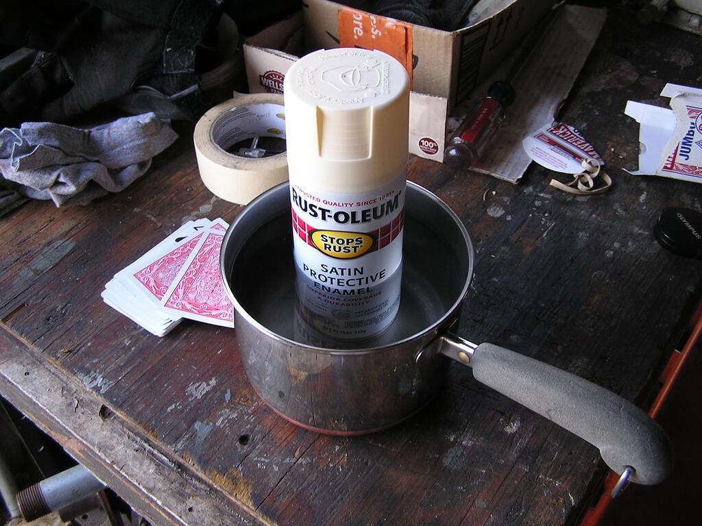

ri702bill 11,712 #5 Posted February 1, 2024 I do the same with the "Dollar Store" playing cards. I also heat up the can of paint prior to and during use. Half a sauce pan of tap hot water works fine. thins the paint and raises the pressure in the can - win, win. DO wipe off the can each time it comes out of the pan before painting !!..... 5 Share this post Link to post Share on other sites

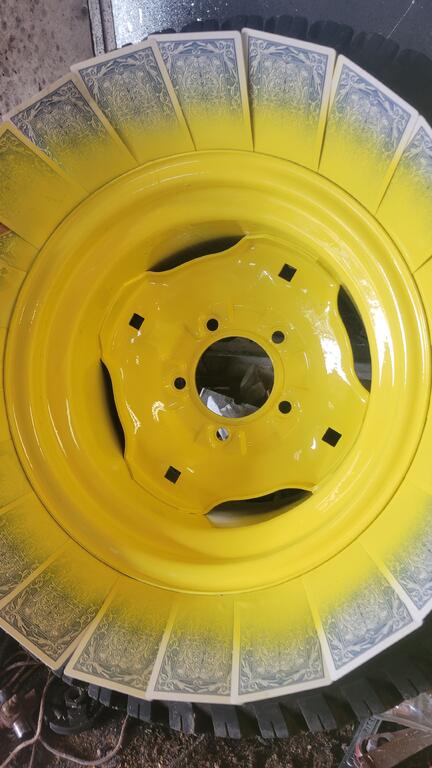

Pullstart 69,552 #6 Posted February 1, 2024 @RED-Z06 great post, but why did you burn our retinas with yellow? 5 1 Share this post Link to post Share on other sites
RED-Z06 2,718 #7 Posted February 1, 2024 3 hours ago, ri702bill said: I do the same with the "Dollar Store" playing cards. I also heat up the can of paint prior to and during use. Half a sauce pan of tap hot water works fine. thins the paint and raises the pressure in the can - win, win. DO wipe off the can each time it comes out of the pan before painting !!..... We used to heat nitrous bottles with blow torches to raise bottle pressure, ive thought about it with paint but even the devil on my shoulder says i probably shouldn't 🤣 2 Share this post Link to post Share on other sites

RED-Z06 2,718 #9 Posted February 1, 2024 1 hour ago, Pullstart said: @RED-Z06 great post, but why did you burn our retinas with yellow? Honestly i don't usually bring my phone out into the shop, it usually ends up damaged, that particular time though i had it with me. The 702 wheels i had to put new tires on and thats the last WH set ive done in 3 or 4 years. 2 Share this post Link to post Share on other sites

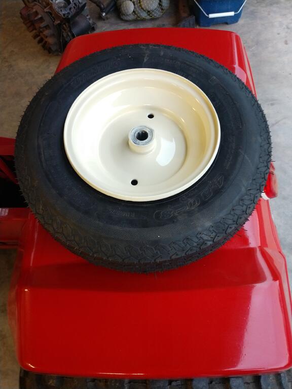

Brockport Bill 2,272 #11 Posted February 2, 2024 just curious????????? Wondering how everyone cleans up the rims? Some are in already in ok shape, others terrific condition - - and others pretty rusted. I have had some I wanted to look excellent so I had professionally sand blasted then I painted -- others i have used 4 1/2 inch 90 degree angle grinder with sanding disc but can only reach limited areas on rear rims. I combine sanding with smaller mini hand held rotary air grinder to sand - plus often had to resort to hand sanding for areas tools can't get -- As we know many areas around inside of rims are challenging to access -- NOT fun! I suppose some people just superficial sand then paint over rust?? What's everyones preferred method to prep the rims ? Thanks 1 Share this post Link to post Share on other sites

kpinnc 17,692 #15 Posted February 2, 2024 (edited) 12 hours ago, Brockport Bill said: Wondering how everyone cleans up the rims? If I were painting the wheel in your pic, I typically just sand the rough spots by hand with 120 grit. Just to remove the rust and get back to paint that is still adhered. I sand the spot until I can't feel the edge of a bad spot. Then I do a "scratch" with 220 or so all over the wheel, and clean it with a decent degreaser. I prime with red oxide and then paint. Never had any breakout rust after. Some of my wheels were painted more than 10 years ago, and they are still good. Edited February 2, 2024 by kpinnc 2 1 Share this post Link to post Share on other sites
Brockport Bill 2,272 #16 Posted February 2, 2024 3 hours ago, kpinnc said: If I were painting the wheel in your pic, I typically just sand the rough spots by hand with 120 grit. Just to remove the rust and get back to paint that is still adhered. I sand the spot until I can't feel the edge of a bad spot. Then I do a "scratch" with 220 or so all over the wheel, and clean it with a decent degreaser. I prime with red oxide and then paint. Never had any breakout rust after. Some of my wheels were painted more than 10 years ago, and they are still good. that creme color and its finish is terrific --- the wire wheels are also one of my go to - - fortunately i have enough various tools and attachments that can usually navigate the different challenges in the rims awkward shapes -- always trying to minimize the hand sanding - - but using hand power is usually unavoidable -- thanks for the tips 4 Share this post Link to post Share on other sites
