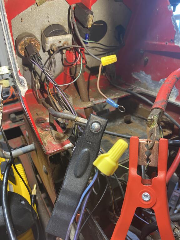

PWL216 1,148 #1 Posted January 28, 2024 I’m trying to get a C-105 to crank over, with a new battery - nothing I’ve done so far has worked… Turn the key, nothing Jumped it at the starter, cranks Jumped it at the solenoid, cranks Apply power to solenoid trigger wire, cranks Replaced the key switch, no crank Bypassed all safety switches, no crank Jumped the ammeter, no crank Checked continuity of all connections, no crank Checked all fuses, no crank ** There is on disconnected wire, shown in pic, that I grounded, no crank. Im fairly sure there’s an incomplete circuit, but I’m not finding it. Any ideas? Thx. IMG_0241.MOV 1 Share this post Link to post Share on other sites
pfrederi 20,060 #2 Posted January 28, 2024 Think your loose wire should go to battery + 1 Share this post Link to post Share on other sites

PWL216 1,148 #7 Posted January 29, 2024 4 hours ago, pfrederi said: Think your loose wire should go to battery + @pfrederi Thank you! This was the problem. I thought I had tried that but apparently I hadn’t. 1 5 Share this post Link to post Share on other sites
