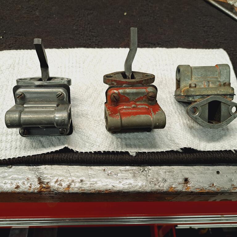

WHX?? 54,974 #6 Posted January 27, 2024 (edited) 7 hours ago, RED-Z06 said: I pull the pulse feed while idling..if theres fuel in the pulse line the pump diaphragm is compromised No can do Red ... the pump is bolted to the block and recieves it pulses directly so ther is no pulse line. One of these days went EB is not retired and has the time to doing an instructional of rebuilding them he will do so. I'll help you out EB I have all the pics... Edited January 27, 2024 by WHX?? 1 Share this post Link to post Share on other sites

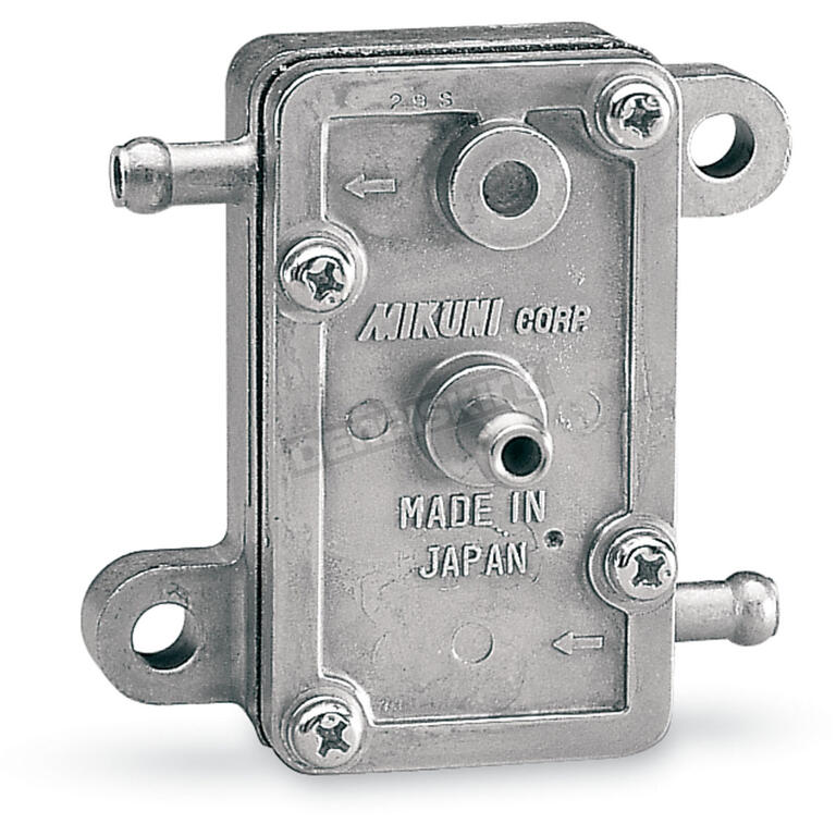

Racinbob 12,765 #12 Posted January 27, 2024 (edited) @RED-Z06 Apparently you haven't dealt with a pulse pump on a K series. Go back to Jims post #6. The pump on the right is a pulse style on the K's. The style you pictured is an aftermarket and also used on other engines. Making a plate to cover where the original pump mounts, drilling and tapping it for a hose fitting and you can use the style you pictured. Edited January 27, 2024 by Racinbob Share this post Link to post Share on other sites
RED-Z06 2,716 #13 Posted January 27, 2024 4 minutes ago, Racinbob said: @RED-Z06 Apparently you haven't dealt with a pulse pump on a K series. Go back to Jims post #6. The pump on the right is a pulse style on the K's. The style you pictured is an aftermarket and also used on other engines. Making a plate to cover where the original pump mounts, drilling and tapping it for a hose fitting and you can use the style you pictured. That's why i asked, given the same mounting point, same physical size, why would they opt for 2 separate drive styles (air pulse vs mechanical). 1 Share this post Link to post Share on other sites

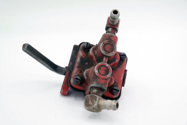

Handy Don 15,937 #19 Posted January 27, 2024 14 hours ago, RED-Z06 said: So we're all on the same page, K181 has a port below the carb on the front of the block, for a mechanical pump that rides on the cam... As shown below, same port on the K181 engine has been used by BOTH cam/lever driven and pulse-only pumps. Several threads here have caught this. One might think that with a well-functioning breather that there wouldn’t be enough crankcase pressure change to make this work, but when you look a the area of the diaphragm and the very small amount of movement needed to pump adequate fuel for each combustion cycle, it is clear that it can (and does) work. Of course, this probably requires a tank above or very near the pump level but this was true of most WH’s and, I suspect, ALL of those that used K181s. 14 hours ago, WHX?? said: 1 Share this post Link to post Share on other sites
