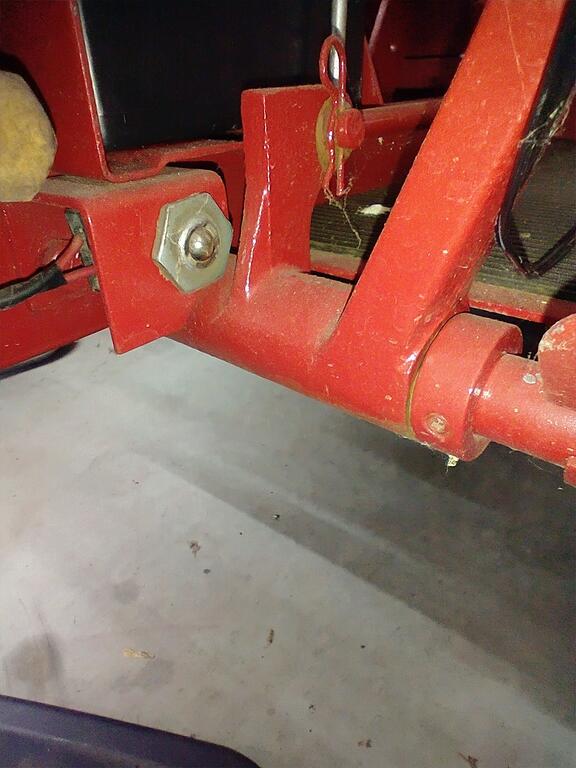

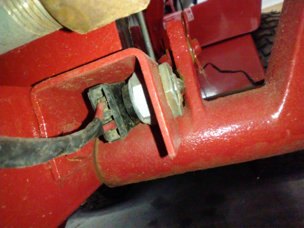

rmaynard 16,989 #6 Posted January 24, 2024 (edited) If your 1977 B-100 has an original wiring harness, bypassing should be simple. Here is a picture of the clutch interlock switch on my B-100 Here is a picture viewed from the underside front. That is a slide-on connector. Grab it with a pair of needle-nose pliers, pull it off, then using a paperclip or some other device, jump the wires in that black connect. That should prove a fault in the switch. The switch is not difficult to remove. Edited January 24, 2024 by rmaynard 2 Share this post Link to post Share on other sites
Tonytoro416 1,312 #7 Posted January 24, 2024 The switch are simple. Hot in and out out When the switch is made it interrupts voltage. Take your plug and unplug it from switch and use a small jumper wire stuck in one side of plug to the other side of plug. Eliminating the switch essentially 1 Share this post Link to post Share on other sites
