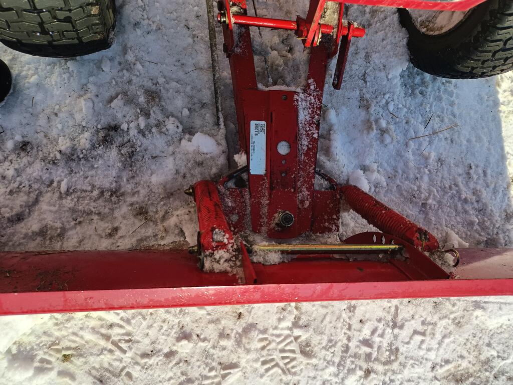

ebinmaine 81,032 #26 Posted January 24, 2024 On 1/22/2024 at 11:43 PM, Ed Kennell said: Spring lift assist Would this be part of another implement? On 1/22/2024 at 6:37 PM, sparkys toy said: This came factory on it this blade Can you post a close up of the numbers on that plow blade? I'm curious to know what it came off of. 1 Share this post Link to post Share on other sites

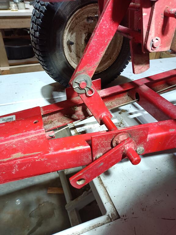

ebinmaine 81,032 #27 Posted January 24, 2024 On 1/22/2024 at 1:53 PM, pfrederi said: I made it a part of my front weight carrier. need that weight to counter the side push of eh 56 inch blade. You have to slot the hole in the plow frame part to allow for raising an lowering the blade. Leave it snug on the sides... On 1/22/2024 at 1:53 PM, pfrederi said: Paul, what did you use for Rod there? 3/4-in and then threaded at the top? 1 Share this post Link to post Share on other sites
pfrederi 21,268 #28 Posted January 24, 2024 Deheaded Gr8 5/8" bolt 2 1 Share this post Link to post Share on other sites
ebinmaine 81,032 #29 Posted January 24, 2024 6 minutes ago, pfrederi said: Deheaded Gr8 5/8" bolt You don't by chance remember the length? Musta been 8"? Or longer? 1 Share this post Link to post Share on other sites
pfrederi 21,268 #30 Posted January 25, 2024 3 hours ago, ebinmaine said: You don't by chance remember the length? Musta been 8"? Or longer? Will measure tomorrow 1 1 Share this post Link to post Share on other sites

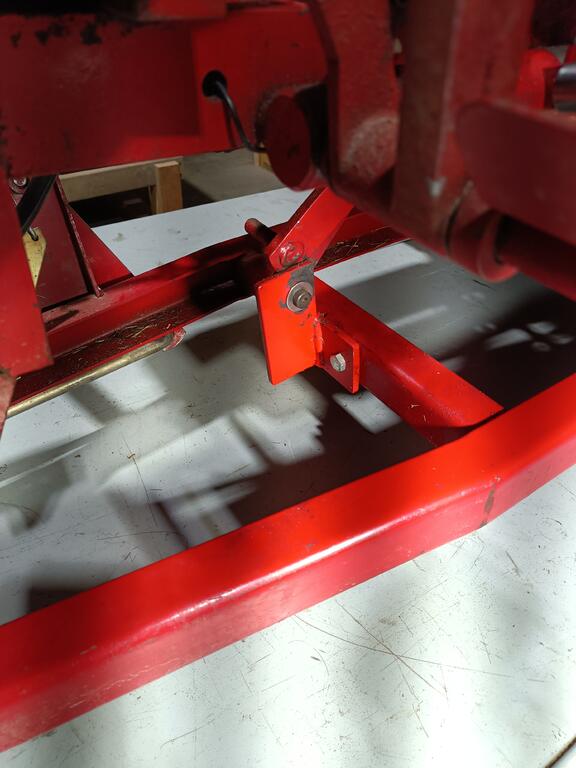

sparkys toy 77 #32 Posted January 25, 2024 On 1/22/2024 at 10:43 PM, Ed Kennell said: Upon further inspection I think that's the original lift point it came with about a 3 foot rod like the one used to operate the angle control lever and the bracket that is on the deck lift arm is not factory and painted a different color 2 1 Share this post Link to post Share on other sites
sparkys toy 77 #33 Posted January 25, 2024 19 hours ago, ebinmaine said: Would this be part of another implement? Can you post a close up of the numbers on that plow blade? I'm curious to know what it came off of. Share this post Link to post Share on other sites
sparkys toy 77 #34 Posted January 25, 2024 20 hours ago, ebinmaine said: Would this be part of another implement? Can you post a close up of the numbers on that plow blade? I'm curious to know what it came off of. 79252 Share this post Link to post Share on other sites
ebinmaine 81,032 #35 Posted January 25, 2024 37 minutes ago, sparkys toy said: 79252 So here's some interesting information. The bracket you're looking for information on is, as you stated a couple posts back, the original lift bracket. It fits a 260 series. It was not intended to fit a B C 3 or 400. If you click on the link above, you can see where one of our members adapted a 260 plow frame to his own 3 4 500. So that's not actually a stabilizer bracket. Seems to function just fine as one though. Share this post Link to post Share on other sites
Ed Kennell 47,729 #36 Posted January 25, 2024 2 hours ago, sparkys toy said: Upon further inspection I think that's the original lift point it came with about a 3 foot rod like the one used to operate the angle control lever and the bracket that is on the deck lift arm is not factory and painted a different color Aha, as Mr. Frank Harvey would say "And now we know the rest of the story.". 1 Share this post Link to post Share on other sites

pfrederi 21,268 #39 Posted January 25, 2024 17 hours ago, ebinmaine said: Much appreciated sir. 10 inch 1 Share this post Link to post Share on other sites

sparkys toy 77 #43 Posted January 26, 2024 22 hours ago, sparkys toy said: Upon further inspection I think that's the original lift point it came with about a 3 foot rod like the one used to operate the angle control lever and the bracket that is on the deck lift arm is not factory and painted a different color Just wanted to thank everyone for your feedback on the snow plow mystery of what machine this came off of,it works great and should serve me well as long as I get the spool valve rebuilt leaking pretty bad as of the last ft of snow it had move On 1/23/2024 at 7:34 AM, peter lena said: @sparkys toy another vital part of plow / blade set up is to build it up on 2 milk crates , one up front just behind quadrant area , the other in the back of frame , giving you a TOTAL LOOK SEE AT EVERY FUNCTION ! correct / improve as you go , also set up swing lever mounting / detailing , to improve and eliminate drag , this crate support state , is exactly like hanging from tractor . have someone else , swing lever / plow , so you can watch and improve . those elastic nuts , washers , lube let you , dial in a perfect easy movement , and lock nut it in place . note the squeeze lever , pull rod , small channel lock , tighten up end connections, eliminate play , lubricate . oil down plow blade front , for snow slide .what ever you build in , is exactly what you will hook up , done this for years , that quadrant , will / should work like a rifle bolt , smooth / very solid , improve it , Pete Share this post Link to post Share on other sites
