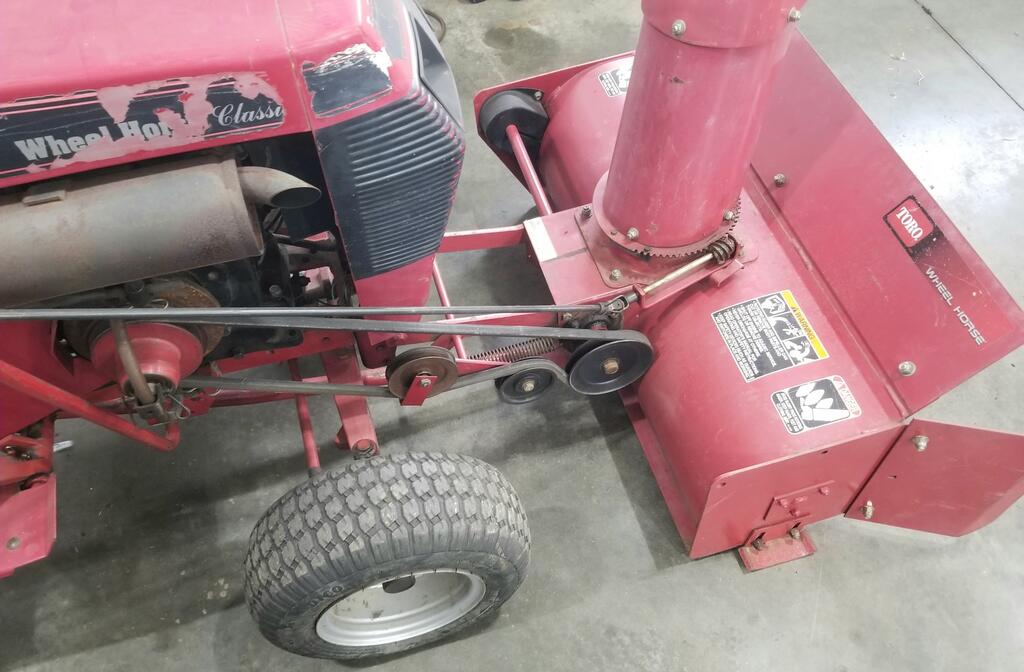

peter lena 9,594 #4 Posted January 21, 2024 @Shuboxlover glairing to me , made improvements, that drive / idler pully frame , is steel to steel / rust mount , lubricate it , also the idler pulleys , could probably , get a RE GREASE , original grease fails , and reduces drive speed , also increases PTO drive clutch wear . lube up ,chute base / gear drive to it . my blowers move easily , by hand at the belt drive area , also get after , auger chain adjustment , 1/2 " and use a specific chain lubricant on it . realize this not what you are asking for , but its definitely related , easy rotational speed , is telling you things are good , a screaming / dragging belt drive is telling you , it should be better . you might also have someone else , slowly engage what you have , so you can see the rusty , dragging areas , aerosol penetrant / red grease , is very good . just some ideas , Pete 1 Share this post Link to post Share on other sites

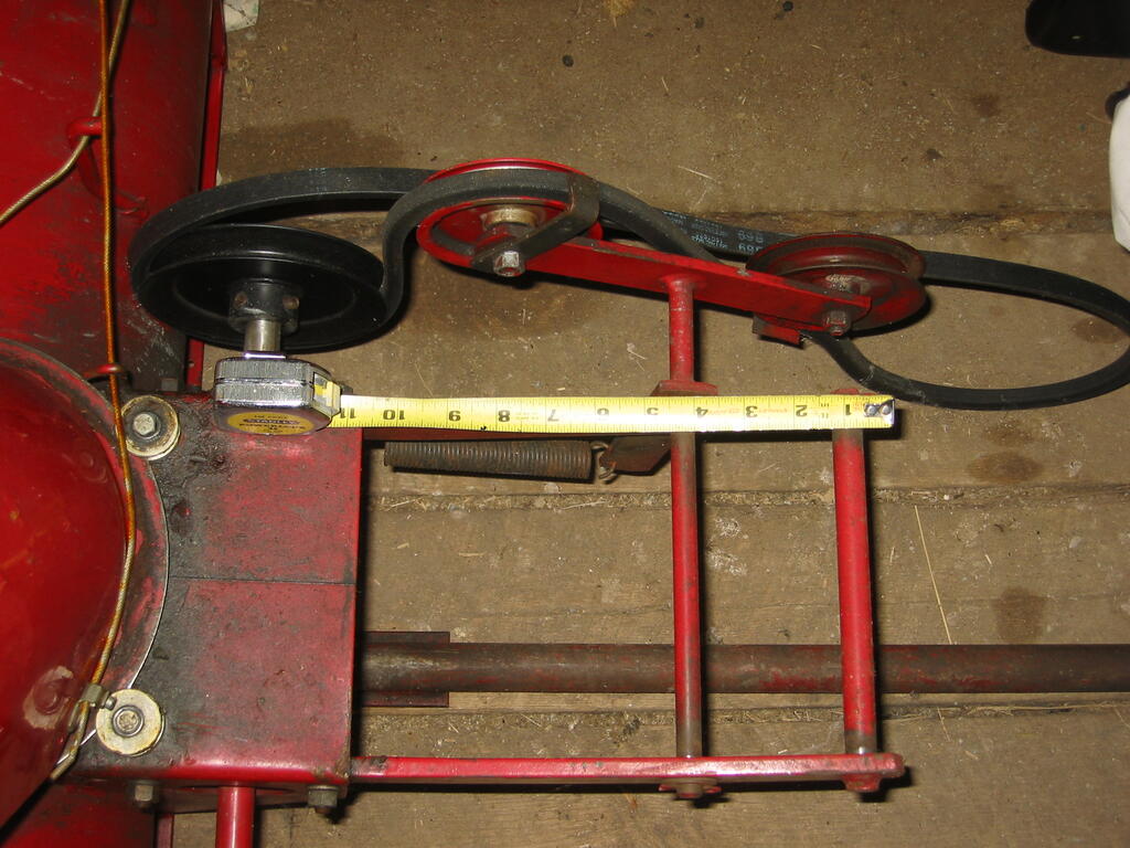

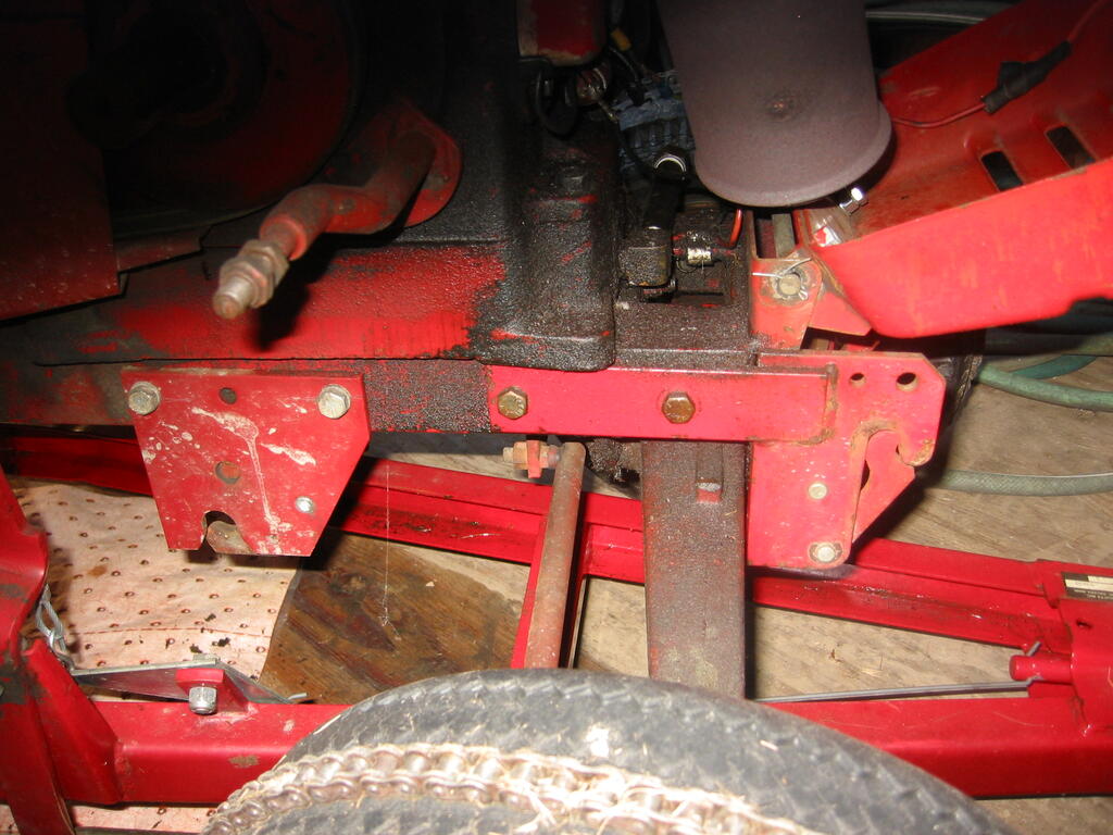

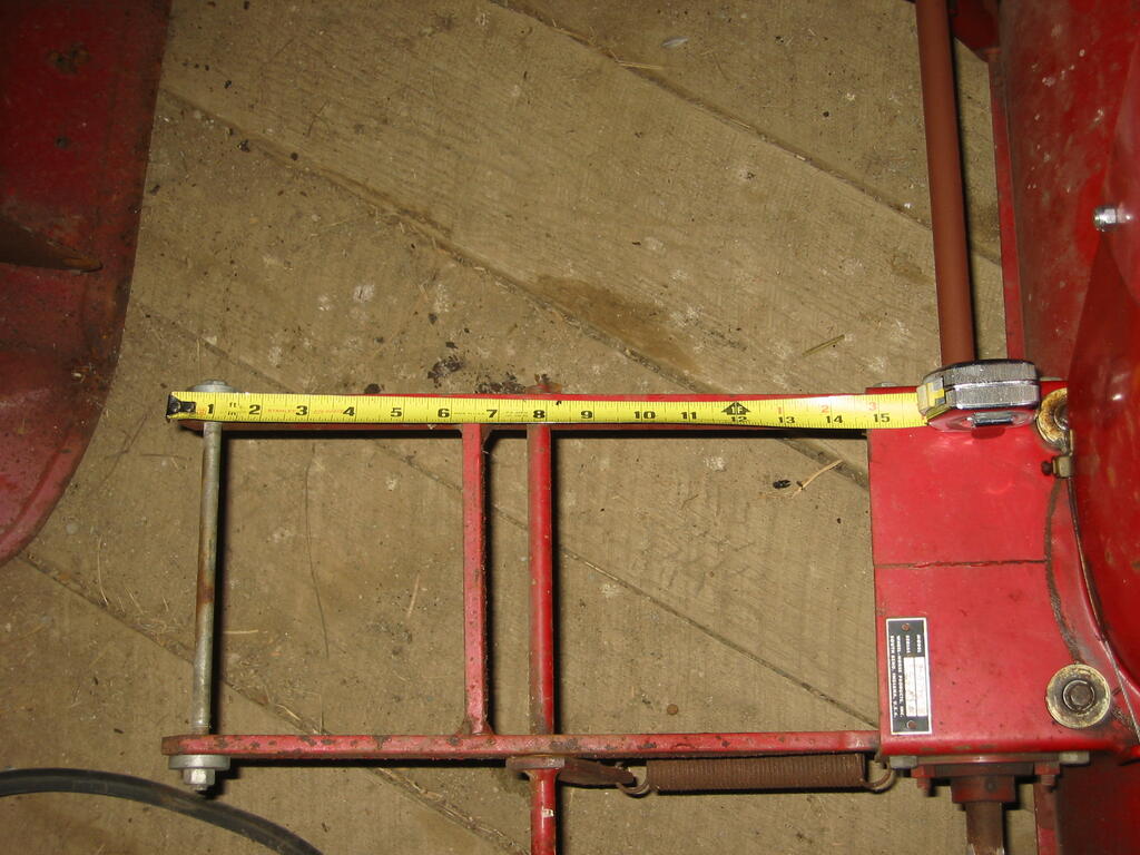

pfrederi 19,374 #6 Posted January 21, 2024 Couple alternatives Along Wallfish's idea there is a Wheel horse bolt on pair of plates that let you use a front tachmatic. Have to look part number up for you later see it in pic 1 or replace the mounting frame with one from a pretachmatic blower... it bolts right into the blower housing and you use a long bolt through the tractor frame pic 2 is for tachmatic pic 3 direct bolt to frame. 2 Share this post Link to post Share on other sites

pfrederi 19,374 #8 Posted January 21, 2024 side Plates are 8-5551 The bolt through mounting frame is 6424 Share this post Link to post Share on other sites
