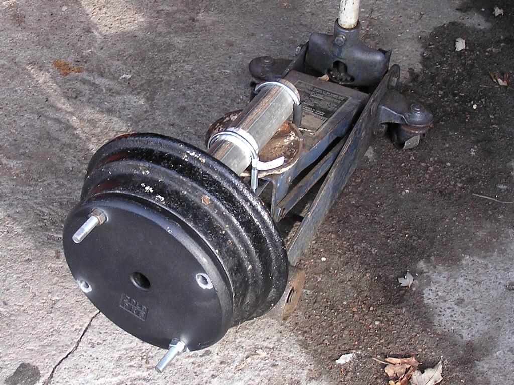

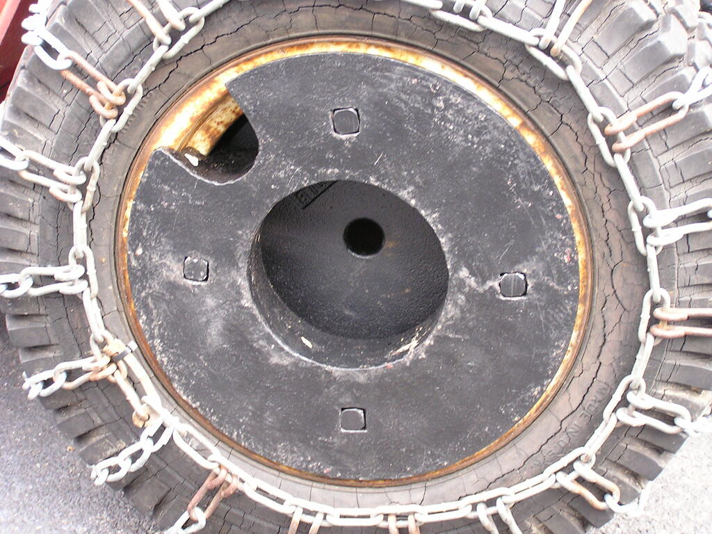

ri702bill 10,084 #12 Posted January 21, 2024 Agree that added weight - in or on the wheels / tires is a better choice than comparable weight added to the frame / hitch. I use 2 link chains, fluid filled tirea and 95 lbs of cast weights - all as described above. 4 Share this post Link to post Share on other sites
squonk 44,650 #13 Posted January 21, 2024 Looks like those chains are keeping the tire together! 1 3 Share this post Link to post Share on other sites
ri702bill 10,084 #14 Posted January 21, 2024 (edited) 2 hours ago, squonk said: Looks like those chains are keeping the tire together! Only half of the story - the filled tubes exert the force to keep the chains tight with the tire as the meat in middle of the baloney sammich!! Besides- thems is O-riginal Carlisle Turf Savers - still up to the seasonal task... Edited January 21, 2024 by ri702bill 2 Share this post Link to post Share on other sites
