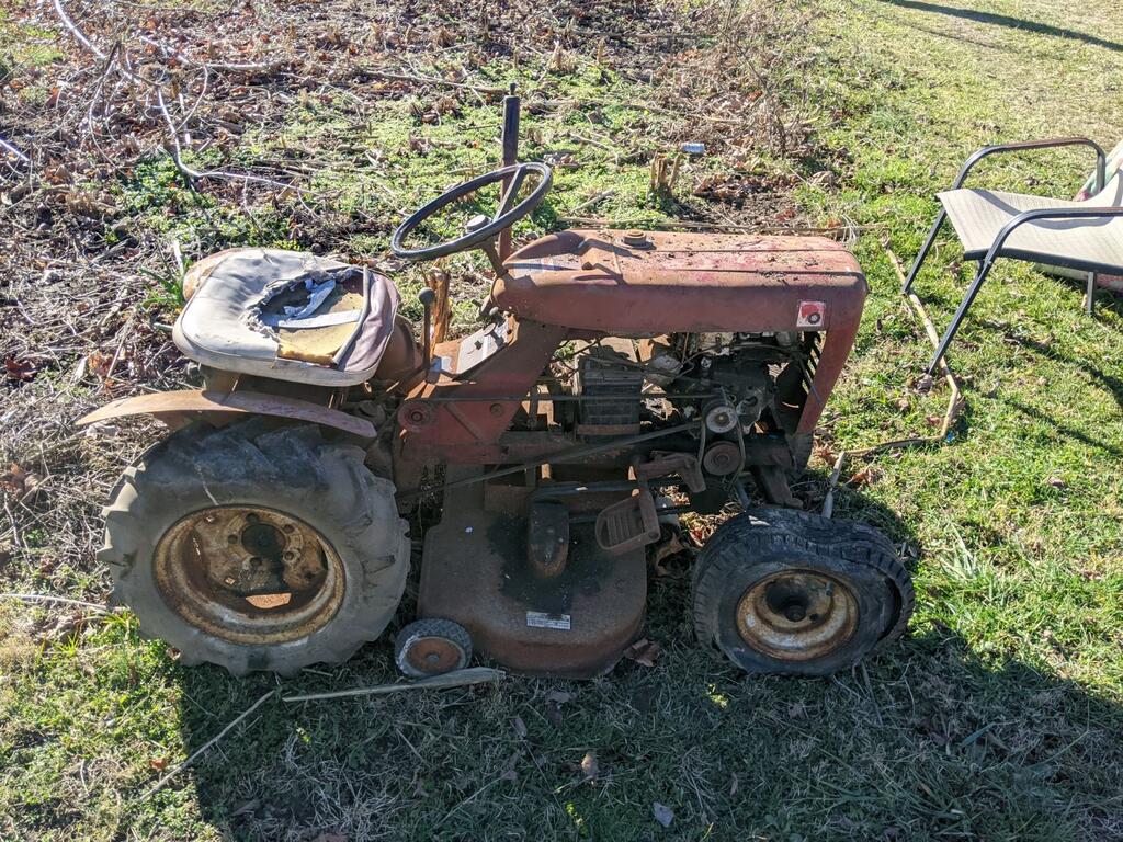

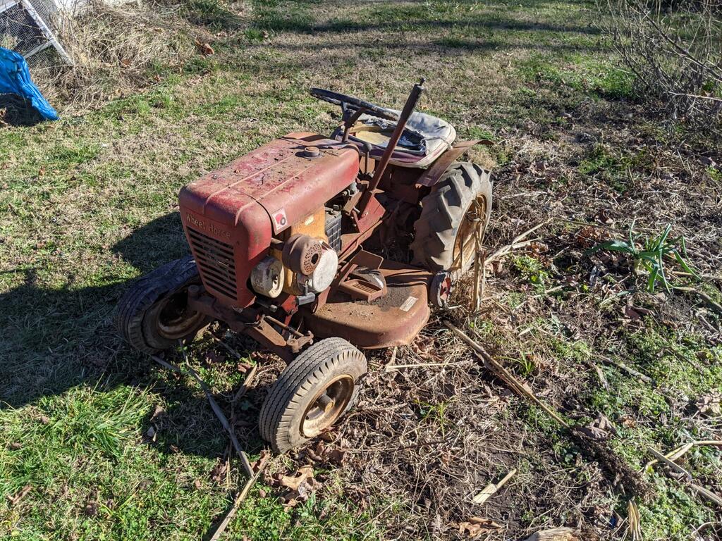

DPrice 24 #1 Posted January 20, 2024 Got it for free needs a few things lol. hoping to find a SR-64 kit for it, serial # is A5972. Anyone sell patch panels for the hoods? 4 2 Share this post Link to post Share on other sites
oliver2-44 10,627 #2 Posted January 20, 2024 Nice project tractors. Lots of friendly help here. I saw your looking for an H60 engine, what's on it now? You might consider putting Kohler K161,181 on it. The Tecumseh ignition parts are getting hard to find and can be cantankerous to work with. 2 Share this post Link to post Share on other sites
DPrice 24 #4 Posted January 20, 2024 It has a H80 off I think a snowblower on it. It's stuck. I'd like to put it back to original, I actually enjoy looking for parts. 2 Share this post Link to post Share on other sites

wallfish 17,952 #6 Posted January 20, 2024 A 654 is used for my snow plow tractor. There's lots of Lawn Rangers that used that same hood. You'll need a belt guard too unless you can find one of those kits which come with one. SR-64 speed reducer kit is going to be a very tough one to find. But you can reduce the speed by using a bigger drive pulley on the trans. Do you have a tiller as well? 1 Share this post Link to post Share on other sites

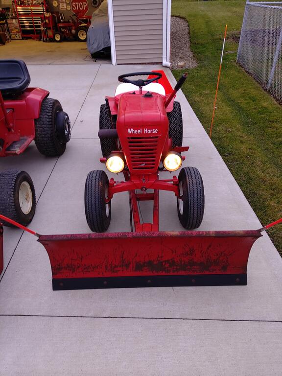

ML3 1,608 #10 Posted February 21, 2024 (edited) Welcome!! I use my 654 for plowing snow. Was surprised at how good it does. I also have a mower deck so sometimes I mow with it when I wanna just "play" It's still got original Tecumseh in it. Feel free to ask any questions. Edited February 21, 2024 by ML3 1 3 Share this post Link to post Share on other sites
953 nut 59,541 #11 Posted February 21, 2024 You are of to a good start, the 654 looks very complete and just needs the belt guard. Most people seem to want their to go faster. You have the right idea, slow down and get more seat time. 1 Share this post Link to post Share on other sites
