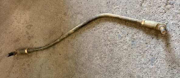

JoeM 10,318 #26 Posted January 18, 2024 26 minutes ago, wallfish said: If it's going to use the existing rod link connection from the lever to the index of the blade, it will need to use the pin to lock it and absorb the force, or a beefed up rod. That 1/2" rod will bend and it's not designed to hold that kind of pressure pushing in on the right side of the blade. Agree, got to have a stiffer rod. Although, on the xi machines the steering rods are 1/2"x2 foot long and hold up well. (until the daughter barks a tree with the tire. and viola custom) Straighten it out and worked good. 2 1 Share this post Link to post Share on other sites

Handy Don 17,735 #31 Posted January 18, 2024 2 hours ago, JoeM said: (until the daughter barks a tree with the tire. and viola custom) Straighten it out and worked good. My son has lately been at the wheel for a couple of “uh oh” moments. Thankfully, nothing to expensive to fix! 1 Share this post Link to post Share on other sites
