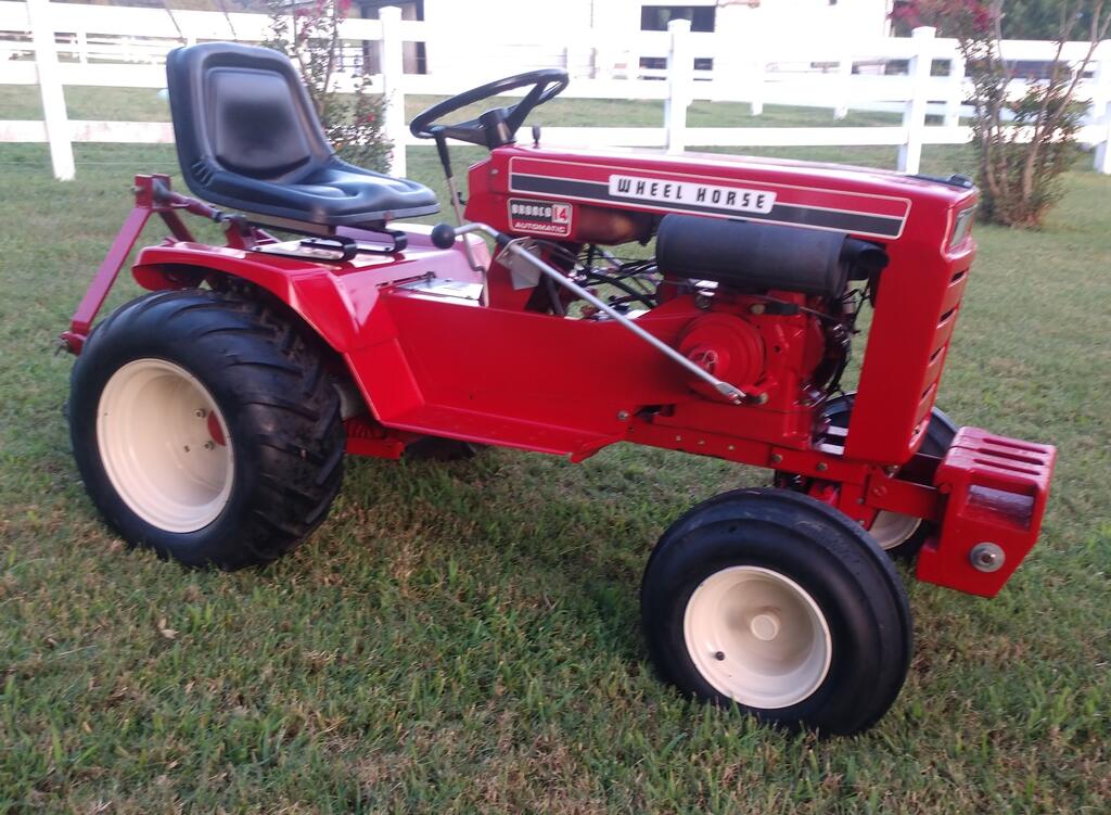

WHGuy413 2,851 #5 Posted January 10, 2024 (edited) I have a Bronco 14 that I love (although souped up with a 18hp twin in it). But What you don’t specify is if the c-161 is an automatic or a 8 speed? Then again maybe it only came as an auto and I just don’t know. But if it’s a gear drive that can make a big difference to people. Some will say each has things they excel at but I do most every task around my place with a variety of tractors with different transmissions. The Bronco should have a hydro lift which is nice for heavy attachments like a snow blower. You can also get down pressure with it on a mid mount grader blade. Curious to see what you end up with. Edited January 10, 2024 by WHGuy413 Share this post Link to post Share on other sites

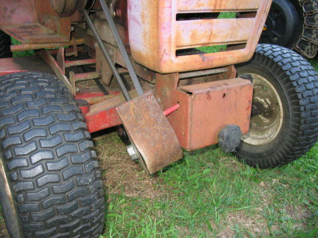

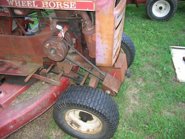

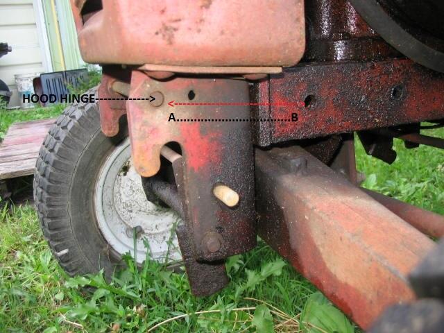

daveoman1966 3,882 #6 Posted January 10, 2024 (edited) I have a Bronco 14.. love it. As for the 'Tach-O-Matic' attachments. All you gotta do is mount a FRONT Tach-o-matic hitch to the tractor. Drill 3 holes and bolt the front hitch ---LEVEL--- onto the hood hinge plate. With that hitch in place, you can ditch the cumbersome and unwieldy side belt drive apparatus and install the front MULE DRIVE in the front hitch. Easy Peasy. I have a .pdf file to lead you thru it. MULE DRIVE UPGRADE DETAIL.pdf Edited January 10, 2024 by daveoman1966 1 Share this post Link to post Share on other sites

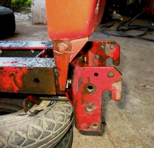

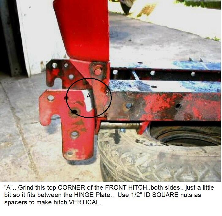

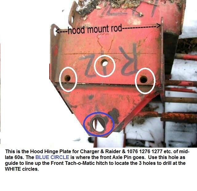

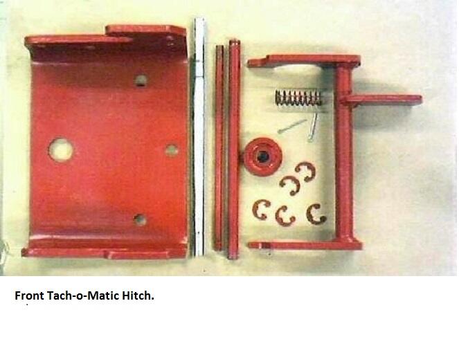

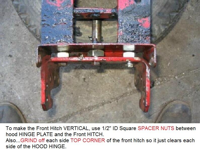

daveoman1966 3,882 #12 Posted January 11, 2024 2 hours ago, Lee1977 said: The mid Tac-o-matic will bolt right up to the existing holes in the frame. You need a good 3/8" drill bit to drill the holes in the front axle bracket regular highspeed bits don't do much with it. . I put both hitches on a Raider 12 I also needed a 5/8" spacer at the top. I used two 1/4" and one 1/8" flats. The Front Tach-O-Matic bracket already has three 3/8 holes drilled in it. All you gotta do is drill 3 holes in the Hood HINGE PLATE and that is only 1/8" mild steel....no special bits necessary. Find three (3) 1/2" thick spacer nuts to bring the front hitch vertical, centered over the 3/4" dia Axle Pin. Here is a front hitch... Share this post Link to post Share on other sites
