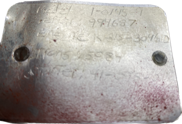

Pogo 57 10 #1 Posted January 8, 2024 Have a K181S from and my 1974 B-80 4 Speed. Engine smokes. ILooking at a ring job and suggestion on how far to go. Problem is the original tg is missing. Someone put a new tag that was engraved with I hope the right info. Can anyone help? Thanks as always guys. Share this post Link to post Share on other sites

gwest_ca-(File Mod) 12,000 #3 Posted January 8, 2024 2 more pages https://www.wheelhorseforum.com/search/?q=1-0145&quick=1&type=downloads_file 2 Share this post Link to post Share on other sites
