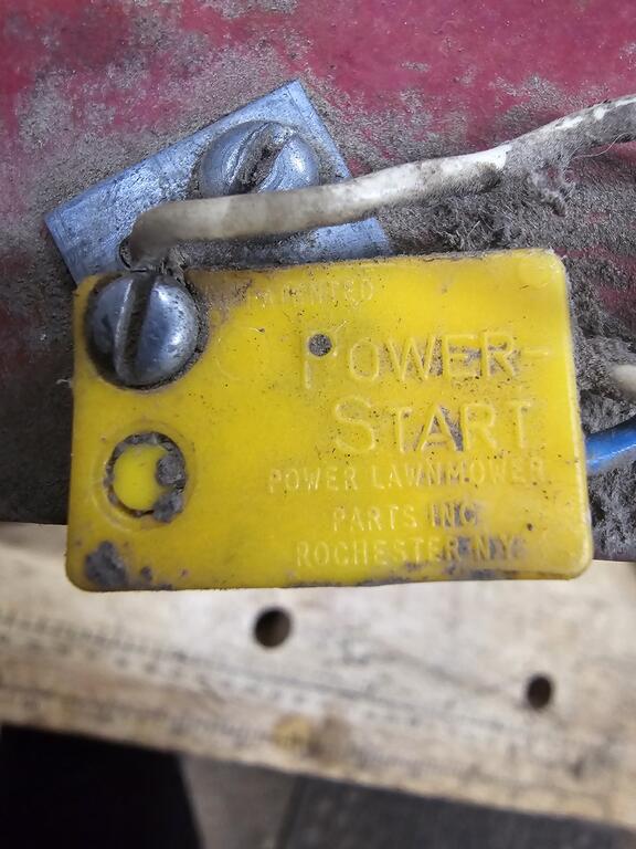

MSBiker 46 #19 Posted March 7, 2024 Well started working on the Wheel Horse again. Had some luck with getting it started. But, it will not reliably start and it will not run for very long. Got it to run consistently one time and I was able to grossly adjust the carb to make it run smooth. Thought I had it but tried to start it again and it still won't start reliably or if it does start it will not run for a full minute. Pulled the tank and cleaned it, it wasn't horrible. I'm going to red coat it tomorrow just to add a layer of protection. Cleaned the pickup screen, it looks good. Added a new fuel line and carb. So fuel system should be good. Orderd magneto parts and while I was disassembling the fan shroud to get at the flywheel/fan I found this little jewel, a thing named Power Start, Power Lawnmower (picture below) that is connected into the ignition. When I pulled it, it had a small crack in the back and looked like the plastic case is bulged a little bit. Not sure what it is (I can guess), but wondering if you folks knew what it is and if it can be causing my issues? Also if I replace the coil on the mag what is the air gap between the coil and the magnets? I am assuming that the pull start H60 on this tractor didn't have a battery (no lights, no electric start), just ran on the mag. Correct me if I'm wrong. Share this post Link to post Share on other sites
Handy Don 15,629 #20 Posted March 8, 2024 Mystery to me! The HH60 in my LR is mag only for ignition but it does have a stator, diodes, and a battery for electric starter. Share this post Link to post Share on other sites
MSBiker 46 #21 Posted March 8, 2024 I think it is a points eliminator. I have one that I will try tomorrow. If it works maybe I won't install the tune up kit I got. I keep hearing about problems getting this Tecumseh H60 engine timed correctly. If you have a procedure for timing this engine I would appreciate the info. Share this post Link to post Share on other sites
RED-Z06 2,700 #22 Posted March 8, 2024 21 minutes ago, MSBiker said: I think it is a points eliminator. I have one that I will try tomorrow. If it works maybe I won't install the tune up kit I got. I keep hearing about problems getting this Tecumseh H60 engine timed correctly. If you have a procedure for timing this engine I would appreciate the info. My method for points Tecumsehs is to pull the head, head gasket, put a dime on the piston, drop it down, put the head back on with no gasket. Rotate the engine clockwise until it stops. Pull the flywheel, set the points to 0.020", then using a buzz box or continuity tester on the points, loosen the coil bracket bolts and make sure the points are in contact (continuity) then slowly rotate the coil bracket until they break continuity..tighten the bracket. The crack should, this whole time, be up against that dime. Now remove the head, the dime, put the gasket back on. I had an HH70 that i fought for days, wouldn't start right, wouldn't idle, wouldn't rev clean..my old boss showed me that trick and bam, 1 pull...tuned it in, ran like a top. Share this post Link to post Share on other sites
