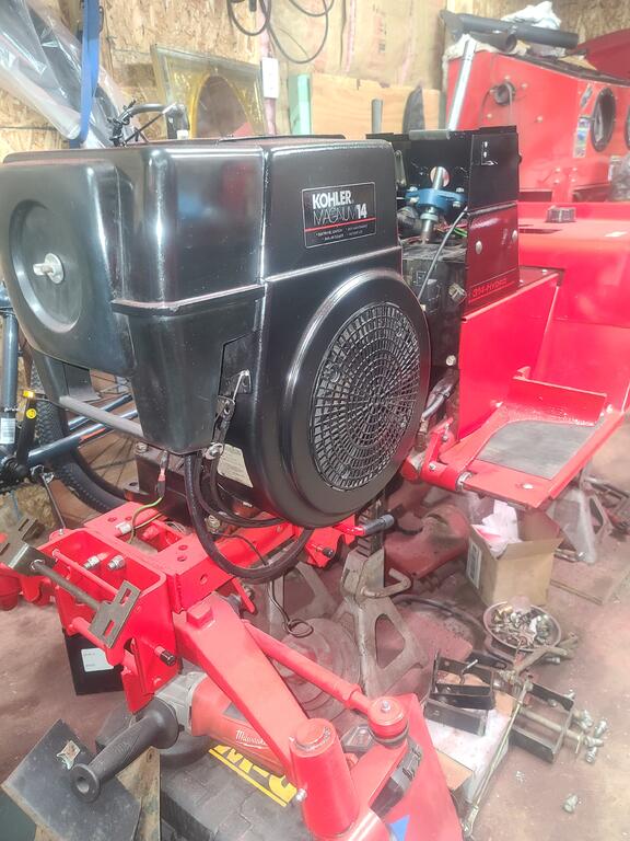

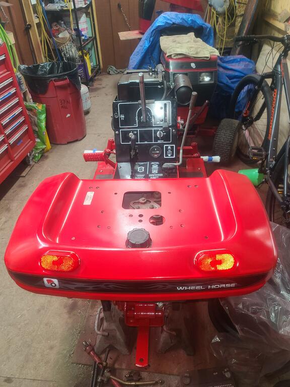

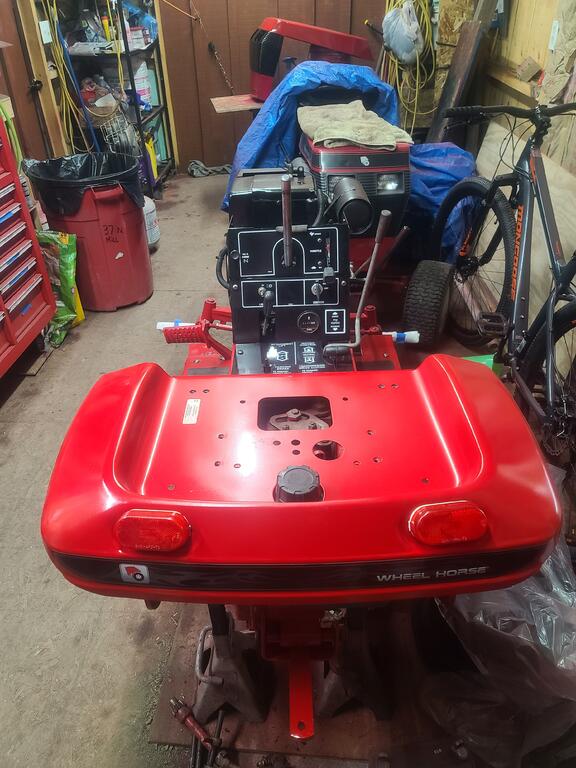

Cee245 881 #53 Posted April 1, 2024 Moving along pretty well... Gotta wait for the hood to dry to install decals and still trying to figure out tire combo.. . . 1 2 Share this post Link to post Share on other sites
ebinmaine 81,282 #54 Posted April 1, 2024 5 minutes ago, Cee245 said: Gotta wait for the hood to dry to install decals Let that set a couple months if possible. Get a good cure. 1 Share this post Link to post Share on other sites
Cee245 881 #55 Posted April 1, 2024 I gave the rear fender and big rectangle shaped one on hood, about a month at 65-72F dry time. Gave the decals on hood stand about 3 days ... they seem fine?. I had to touch up the hood and put clear on it today, so it'll be a while before i will put them on. Eric, I haven't had issues in the past when only waiting a week... what could happen? Ripping/peeling when installing? Paint Drytime under decal? Using same decals / technique as before... 1 Share this post Link to post Share on other sites
ebinmaine 81,282 #56 Posted April 1, 2024 3 hours ago, Cee245 said: I gave the rear fender and big rectangle shaped one on hood, about a month at 65-72F dry time. Gave the decals on hood stand about 3 days ... they seem fine?. I had to touch up the hood and put clear on it today, so it'll be a while before i will put them on. Eric, I haven't had issues in the past when only waiting a week... what could happen? Ripping/peeling when installing? Paint Drytime under decal? Using same decals / technique as before... What it comes down to is "off-gassing" the paint. Whether it's done by a shop using a hardener or sprayed out of a can, paint needs to breathe for a certain amount of time to truly cure. It can shrink a little, but not always. It's entirely possible, and in fact likely, you'll never see an issue after the first 3 or 4 days. 1 Share this post Link to post Share on other sites

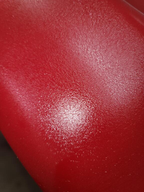

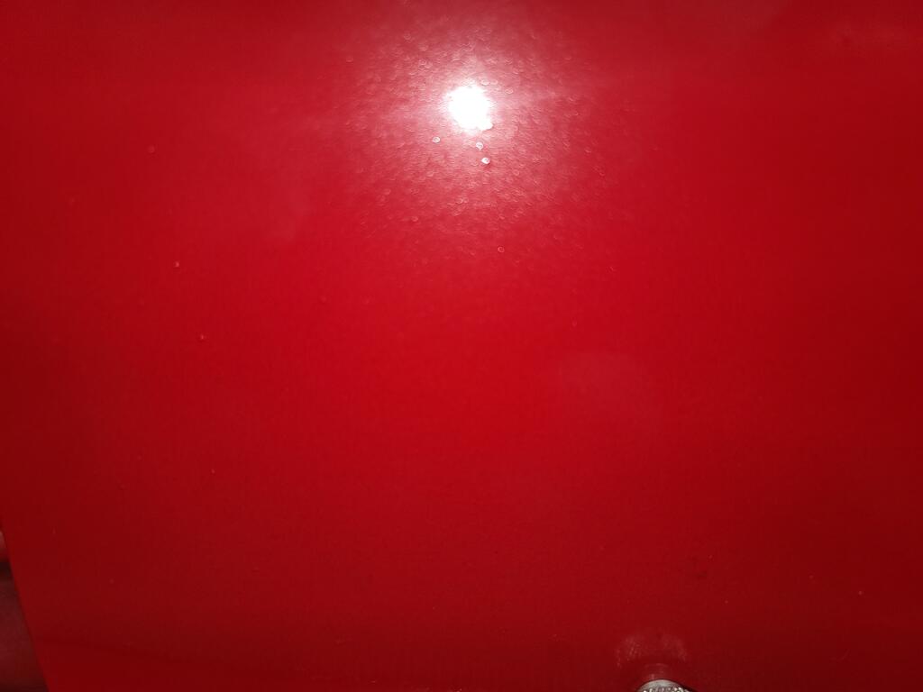

Cee245 881 #59 Posted April 1, 2024 (edited) Lol... ill never understand painting either... i seem to like to not let it dry properly and put runs in etc. I guess we like doing it over.. and over.. lol I have two rear seat pans i keep going back and forth on as i screw up one. . I'm struggling with putting clear down. Kept looking like in 1st pic in spots. 2nd picture is how most everything is. Little dust in it, but will clean up well with 2000 grit. For me, It really comes down to lack of proper equipment/ space / consistent temperature And realistic expectations. So, I'm happy with a decent spray can paint job like we seem to have now as this is our mowing machine, not a sports car. Edited April 1, 2024 by Cee245 Add 2nd pic 2 Share this post Link to post Share on other sites

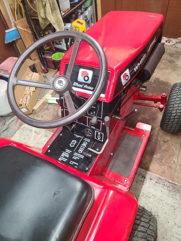

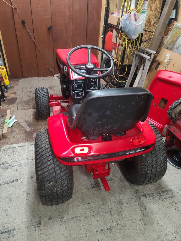

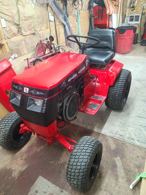

Bill D 3,213 #61 Posted April 13, 2024 1 hour ago, Cee245 said: Very nice. That style steering wheel is my favorite. I have them on all my tractors. 1 1 Share this post Link to post Share on other sites
ebinmaine 81,282 #62 Posted April 14, 2024 Excellent! 1 Share this post Link to post Share on other sites
kpinnc 19,107 #63 Posted April 14, 2024 That paint scheme and decal combo looks really nice! As always- well done! 1 1 Share this post Link to post Share on other sites
