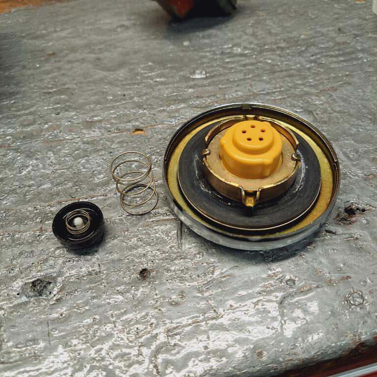

WHX?? 54,974 #11 Posted December 29, 2023 (edited) On 12/24/2023 at 3:50 PM, moe1965 said: Try taking the fuel cap off when it starts to die out could be a simple fix Right you are Moe. After getting the pump to quit leaking it would run fine for abit then starve out. Petcock wide open on a new sediment bowl and would not let gas through. Loosen the cap and poured out. Universal aftermarket gas cap with a check valve for the older one or two piece round hood tanks. Is supposed to let air in but not fumes out. Guess what got ripped out! Pry up on the two tabs aside of the center plastic piece and the check valve comes right out. Plastic piece goes back in for a baffle. Edited December 30, 2023 by WHX?? 1 Share this post Link to post Share on other sites
