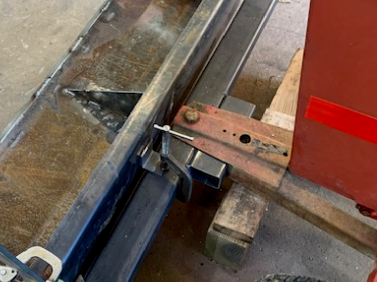

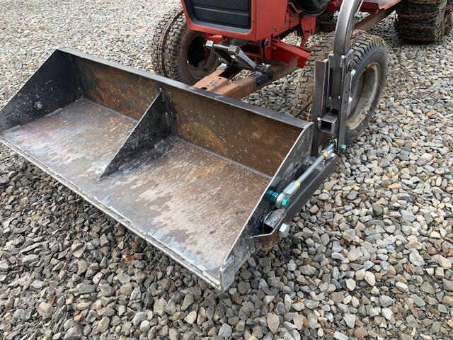

JoeM 9,331 #1 Posted December 22, 2023 Putting together an attachment that uses an existing, mounted, Wheel Horse snow plow frame. The plow and turn handle is removed via the 3/4" swivel bolt. The attachment is simply slid into place and attached using the 3/4" bolt. This unit incorporates a front plow frame anti sway attachment. The anti sway attachment can be left on the plow for either the blade or bucket to stabilize the front during use There is a short video using it to dip a some stone. I tested my hydraulic lift with 300 lbs. and it worked good. If there is enough interest, I was thinking about putting together 3 for the show in June. You will need your own plow frame. C series or 300 400 500. I am trying to get the cost inline but as of now $700 and that includes the stabilizer. PM if interested. 3 16 Share this post Link to post Share on other sites

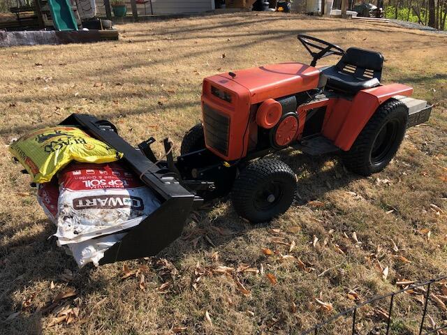

Sailman 1,305 #7 Posted December 23, 2023 Nice job! I built a similar "garden bucket" for my GT 14 using ATV bucket and linear actuator. Its good for about 300 lbs. too. Bucket just dumps but considering adding an actuator to the bucket too. Works fine for my needs and under $1000. I definitely had to add weights off the back for traction even though a GT 14 is a heavy tractor. 3 3 Share this post Link to post Share on other sites

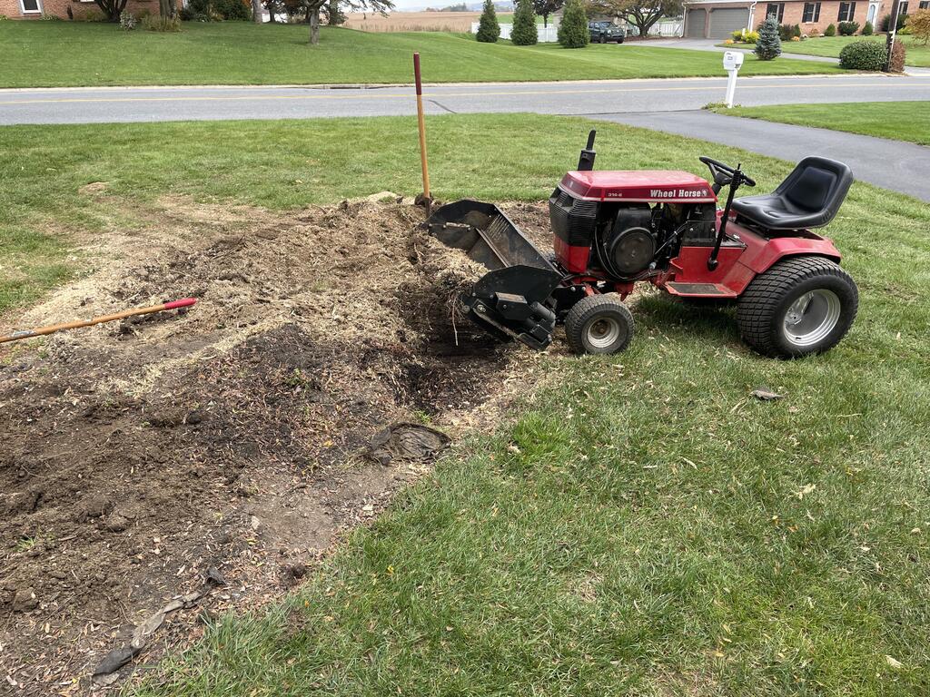

OoPEZoO 578 #10 Posted December 23, 2023 I like it......very similar to the Johnnie bucket. I find mine super useful for hauling and dumping things around the property. Having that powered lift is key, weather its hydro or linear actuator Here is mine at work after having a tree cut down and stump ground out. Worked awesome for moving the debris and then back dragging the fresh dirt to grade 6 1 Share this post Link to post Share on other sites
