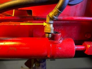

TractorEd 649 #1 Posted December 20, 2023 Leaking from gap shown by yellow arrow. Are these end connectors repairable? Is it a flared fitting underneath? Share this post Link to post Share on other sites

pfrederi 19,865 #4 Posted December 20, 2023 The swivels are not fixable and it is an ORB #5 (or#6) fitting 3 Share this post Link to post Share on other sites

TractorEd 649 #8 Posted December 22, 2023 Lowell’s hydraulic hoses are in my near future. Might as well replace them all while I’m at it. 2 Share this post Link to post Share on other sites
ebinmaine 77,278 #9 Posted December 22, 2023 17 minutes ago, TractorEd said: Lowell’s hydraulic hoses are in my near future. Might as well replace them all while I’m at it. That's what I did. If ones leaking, the others may well be soon. 1 Share this post Link to post Share on other sites
