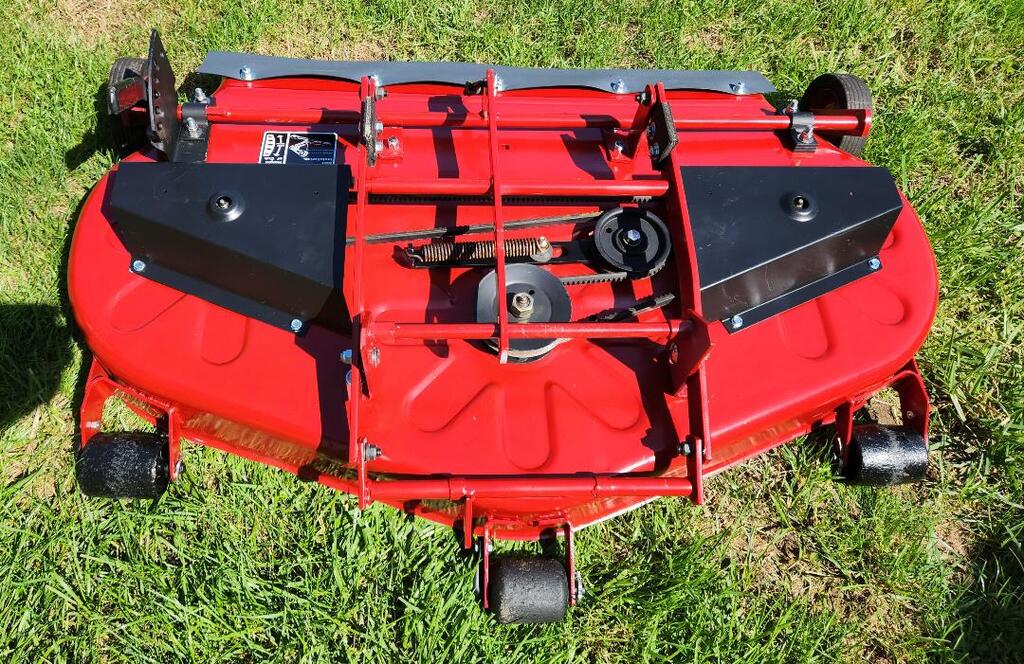

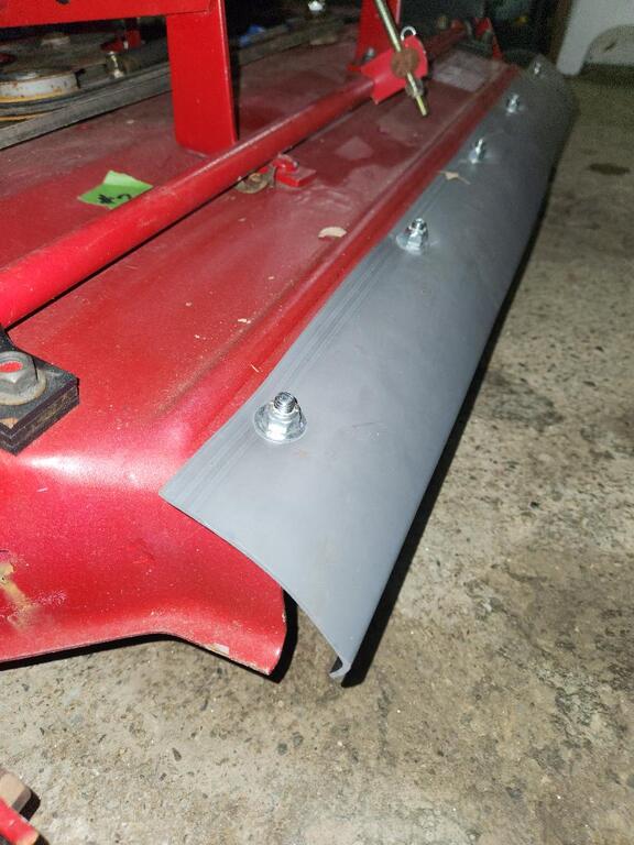

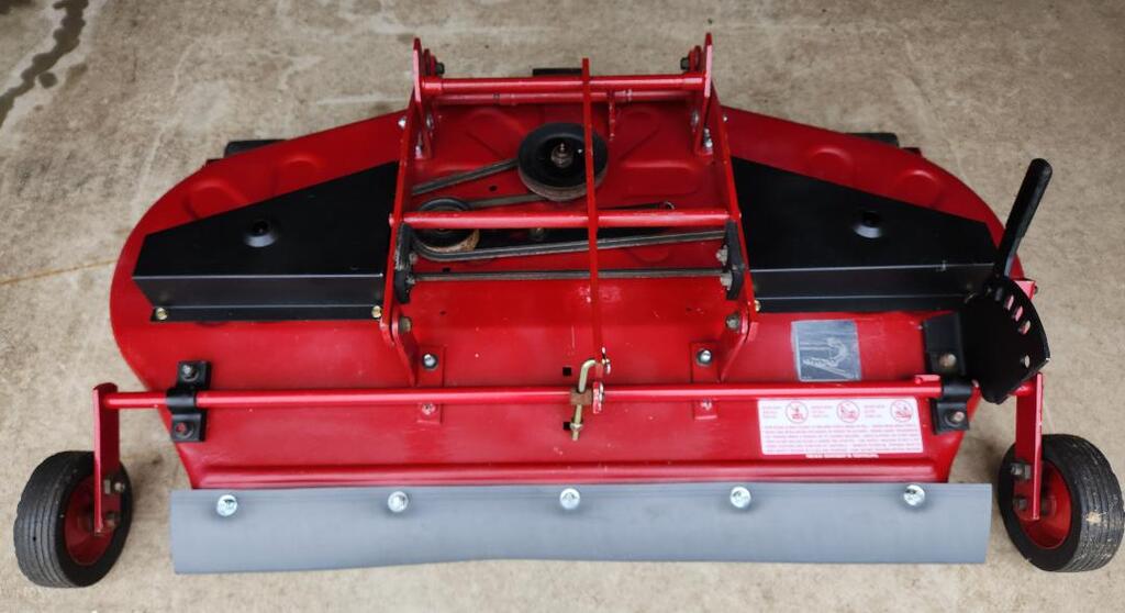

Brockport Bill 2,481 #27 Posted December 12, 2023 9 hours ago, Handy Don said: Tossing in a vote for the 42 RD. Extends just a bit past the track of the (8.5”, no spacer) wheels on both sides so you can get close to flower beds, walls, etc, (It won’t go under a post and rail, though). Gets close on either side which is helpful when you are mowing around a fair number of obstacles. Cut is wide enough that typically you do not need to overlap the tire path from the previous cutting pass. Somewhat heavier than a 36 but still pretty narrow (unless you have a known “37 inch passage” that you must get through!) With a flap on the discharge (we used a piece of 4” vinyl cove), you can keep the clippings very well under control and NONE wind up being sucked in by the engine fan (unless it’s really really dry and windy!) They do poorly at rock chucking. i installed the base cove vinyl flap deflector to a few 42 rd's i did some rehab on -- here are some photos of their attachment -- i use the carriage bolts head underneath so the rounded over head of bolts wont get damaged from debris discharged 3 4 Share this post Link to post Share on other sites
