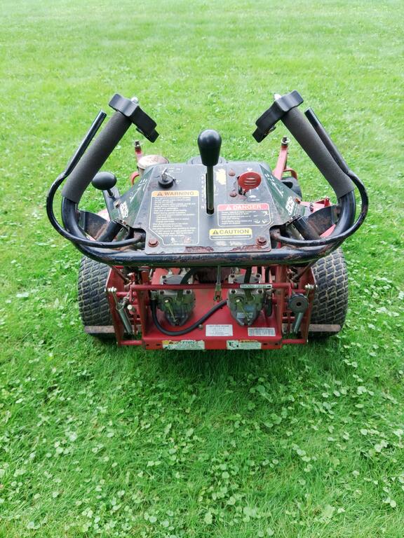

Bill D 2,604 #10 Posted December 9, 2023 55 minutes ago, Handy Don said: I don’t know. Guessing not, at least on the lower end models, since such things add cost and opportunities for misuse and warranty issues. I’ve never heard, for example, of a zero turn having tow valves. The Eaton 1100, for one, uses internal acceleration valves to allow slow movement without power. (BTW, these are darned clever gadgets worth learning about!) I may be wrong but I think all zero turns have tow valves. There's a 5/8" nut on the pumps that you loosen when you need to tow. My Exmark walk behind has two, one on each pump. Pumps are made by Hydrogear. Not sure if you can see the tow valves in this picture. They have 1/4" bolts thru them. 1 Share this post Link to post Share on other sites
Handy Don 15,994 #11 Posted December 9, 2023 4 minutes ago, Bill D said: My Exmark walk behind has two, one on each pump Good info, thanks. So maybe depends on the model! Share this post Link to post Share on other sites

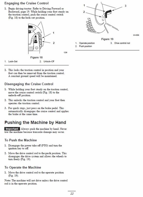

gwest_ca-(File Mod) 12,013 #12 Posted December 9, 2023 From the operator manual and don't miss figure 19 1 Share this post Link to post Share on other sites
grinchsr 657 #13 Posted December 9, 2023 Perfect THANK YOU Share this post Link to post Share on other sites
