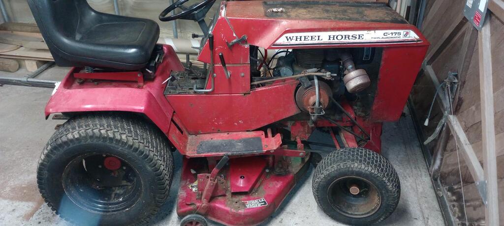

uk175horse 19 #1 Posted November 30, 2023 Hi guys, I picked up a wheel horse here in the UK a few weeks ago, I'm a complete novice when it comes to tractors and engines, so take it easy on me:) Not to mention I'm used to everything metric! Lots of questions in my head , but loads of great knowledge on this site. Anyway the WH is a C175 automatic , model number 01-17ks-9 . I think 1980 or so. So not sure if its built slightly different to the US ones but pretty sure the transmission is the Sustrand one. (oil filter is on right side) Engine is not original though, its a Kohler K341 Comes with a rear discharge deck but needs some work and some patches rusted through. First thing I noticed firing it up a couple times, is that its pretty loud, I don't mind so much but do have some neighbours! It's got a pepper pot muffler on it now and I'm trying to figure out what muffler to switch to which would suit the engine. I've seen a few ideas on here but too many options, not sure where to start! I've measured the exhaust port on the engine and looks like 1 1/2" threaded pipe? the pipe isn't seized up so could be unscrewed easily. Alot of US links here, pretty sure I can order most items from ebay etc and get international delivery though. 2 Share this post Link to post Share on other sites

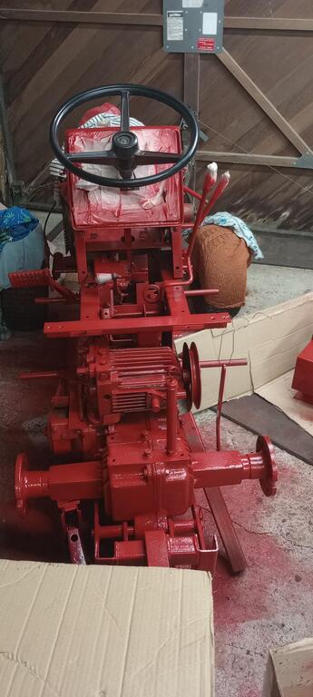

uk175horse 19 #8 Posted November 30, 2023 Thanks for the welcomes! This is how it looked when I picked it up and the transmission - the oil filter is off in the photo but its on the right hand side, not at the back. So any opinions on a good quiet muffler for the K341 engine? slightly prefer something that is down the side or in the front of the hood , but could be a stack too.. Do most of the mufflers clamp onto the threaded to straight pipe adaptor, at the moment I've got a threaded angle piece into a straight pipe with the pepper pot welded on. 1 Share this post Link to post Share on other sites
