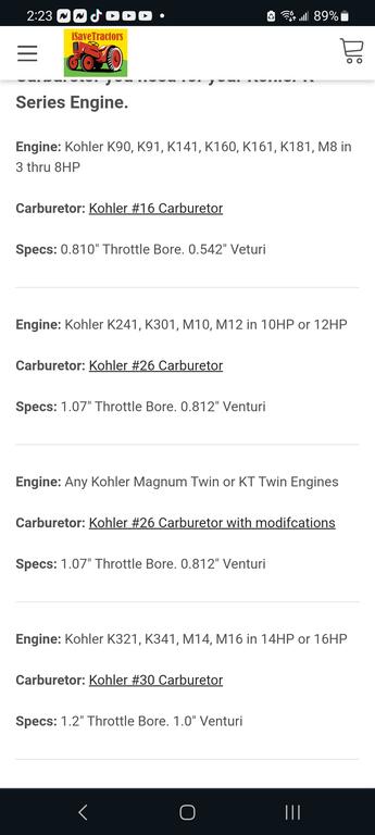

ebinmaine 76,508 #14 Posted November 27, 2023 58 minutes ago, RED-Z06 said: this carb I wonder if that throttle plate would work on the larger 14 and 16 HP Share this post Link to post Share on other sites
RED-Z06 2,700 #15 Posted November 27, 2023 (edited) 12 minutes ago, ebinmaine said: I wonder if that throttle plate would work on the larger 14 and 16 HP If you have a measurement i can go see if i can find out. The venturi and throat are likely larger but the air horn section may not be Edited November 27, 2023 by RED-Z06 1 Share this post Link to post Share on other sites
ebinmaine 76,508 #16 Posted November 27, 2023 8 minutes ago, RED-Z06 said: If you have a measurement i can go see if i can find out. The venturi and throat are likely larger but the air horn section may not be Not sure on the throat. Venturi is definitely larger. I'll check it when I get home. Share this post Link to post Share on other sites
RED-Z06 2,700 #17 Posted November 27, 2023 39 minutes ago, ebinmaine said: Not sure on the throat. Venturi is definitely larger. I'll check it when I get home. Heres the throttle and venturi specs for sure 1 Share this post Link to post Share on other sites
ebinmaine 76,508 #18 Posted November 27, 2023 1 hour ago, RED-Z06 said: Heres the throttle and venturi specs for sure Let me just start by reminding people that I like Norman. He's a good guy. But I can't buy a carburetor from him. We've talked about this in another thread but I have one here with very little hours on it. Couple things in particular I really don't like very much at all. The bore size is not marked in any way. You don't even know what you have in your hands so you don't know what size engine it's supposed to be on. The reason I took it off though: The throttle shaft bore already has premature excessive wear. Unfortunately there's no way to install the brass washers that we've been using to tighten up excessive play. That renders this carburetor as ... no good. I do almost no repairs for paying customers but if I was, I couldn't sell one of these in good conscience. I'm glad that some people are having better luck with aftermarket carburetors than I am. This is at least the fourth or fifth one I've seen in about that many years that isn't usable. I'll stick to my OE Kohlers and rebuilding them. Share this post Link to post Share on other sites
