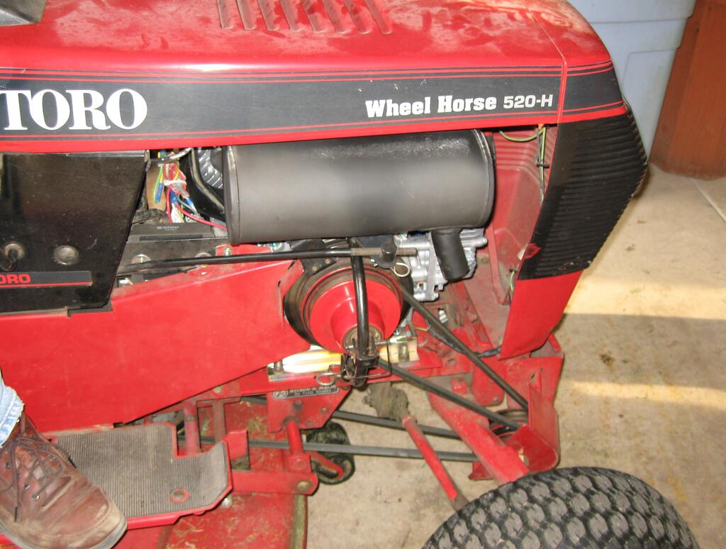

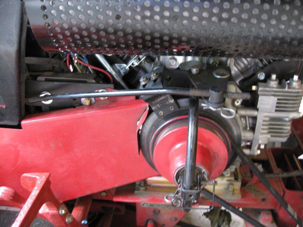

CCW 1,519 #32 Posted December 30, 2023 Made the modification to the muffler mount where it interfered with the PTO's upper bracket. All now fit with one concern I would like your feedback on. The muffler sits lower than the original OEM muffler and the upper PTO link plate rubs the bottom of the muffler. Take a look at the photos and give me your opinion whether this might be a problem. The PTO lever still pivots and does its job. With the muffler getting hot I sure the bracket will be so too, though it will be hot from being bolted to the engine. 1 Share this post Link to post Share on other sites
peter lena 10,073 #33 Posted December 30, 2023 @CCW NICE JOB ON THAT ! , added a HEIM JOINT to that lever attachment , swivels easily with the irregularity , pete 1 Share this post Link to post Share on other sites
kpinnc 18,970 #34 Posted December 31, 2023 6 hours ago, CCW said: With the muffler getting hot I sure the bracket will be so too, though it will be hot from being bolted to the engine. I'd just use some anti-sieze on those threads. The grease will bake out of it, but it will still keep it from rusting solid on there. 2 Share this post Link to post Share on other sites
Handy Don 17,484 #35 Posted December 31, 2023 The muffler will be much hotter than the engine block though I’m not sure it’ll matter to operation. I’d consider carefully “indenting” the area of the muffler nearest the PTO mechanism just to avoid direct friction against the muffler. 3 Share this post Link to post Share on other sites
davem1111 2,372 #36 Posted December 31, 2023 On 12/19/2023 at 5:02 PM, ebinmaine said: I'm looking forward to seeing and hearing how you like that 20+ HP beast. I'm sure he'll love it. I have a GX610 on my GT-1848, and I like it "a lot". Kinda wishing I had the GX630 but this 18hp does everything I ask it to do, so far. The only problem I've had with it is the carburetor has a fuel solenoid that's supposed to shut off the fuel flow as soon as the key is turned off. Solenoid went bad in the closed position. I just took it out and cut off the pin. Don't remember why I didn't order a new one, probably just forgot since it runs fine and I don't get any backfires. Oh, and the PO either put a Briggs and Stratton logo in the middle of the fliywheel screen, or the whole screen came from a B&S. I plan to put a Wheel Horse logo there eventually. I have a spare one from a 416-H steering wheel. 1 Share this post Link to post Share on other sites
Lee1977 7,782 #37 Posted December 31, 2023 (edited) I think Handy Don's ideal of flatting the bottom of the muffler in that area is the best way to fix it. There might be a 1/4" between the muffler and bracket on the 520. Edited December 31, 2023 by Lee1977 3 Share this post Link to post Share on other sites

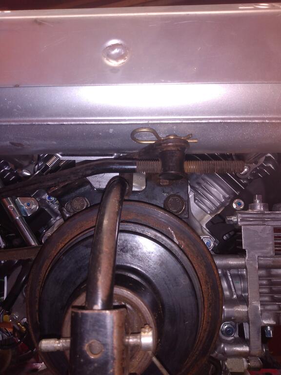

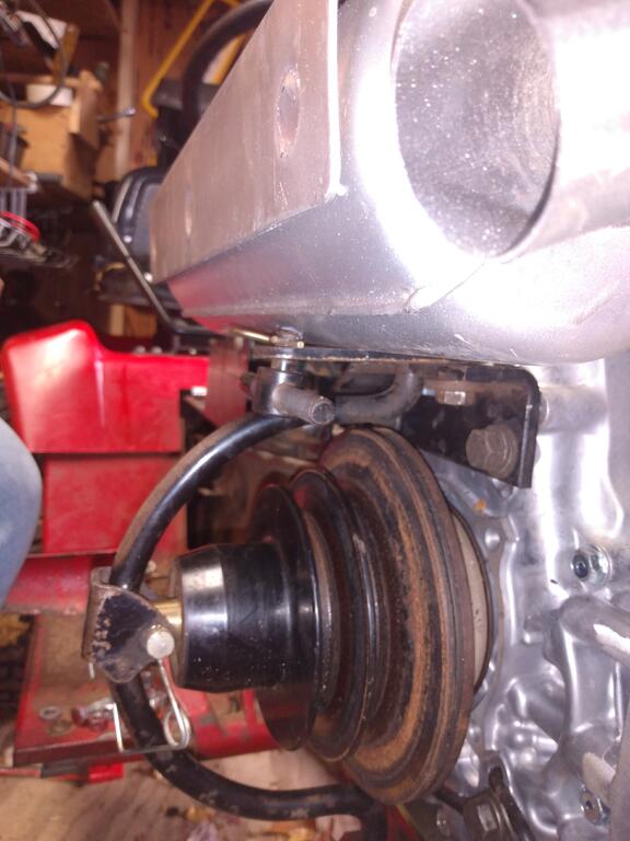

Red-Bovine 337 #45 Posted January 3, 2024 I did my Honda conversion back in 2013. It's been great. Used it for everything like lawn maintenance and snow blowing. about 5 years ago we relegated it to just snow removal and put the Original Cab on it. Used the GX630 Honda from Repower in Oregon. I also had issues with their muffler and replaced it with the Honda High Mount type A. I needed to cut into the hood for clearance, but it fit way better and came with a heat shield. Here is a picture of the Repower muffler and interference with the clutch bracket. 1 Share this post Link to post Share on other sites
Red-Bovine 337 #46 Posted January 3, 2024 Here are pictures of the Honda muffler. Sorry I don't have the part number, but it should be available on line through Honda parts. 2 Share this post Link to post Share on other sites
CCW 1,519 #47 Posted January 3, 2024 @Red-Bovine Thanks for the info. For now I will stick with the one provided. Although you did a great job cutting the hood I just do not want to do that. I might try to indent the bottom of the muffler. 2 Share this post Link to post Share on other sites
