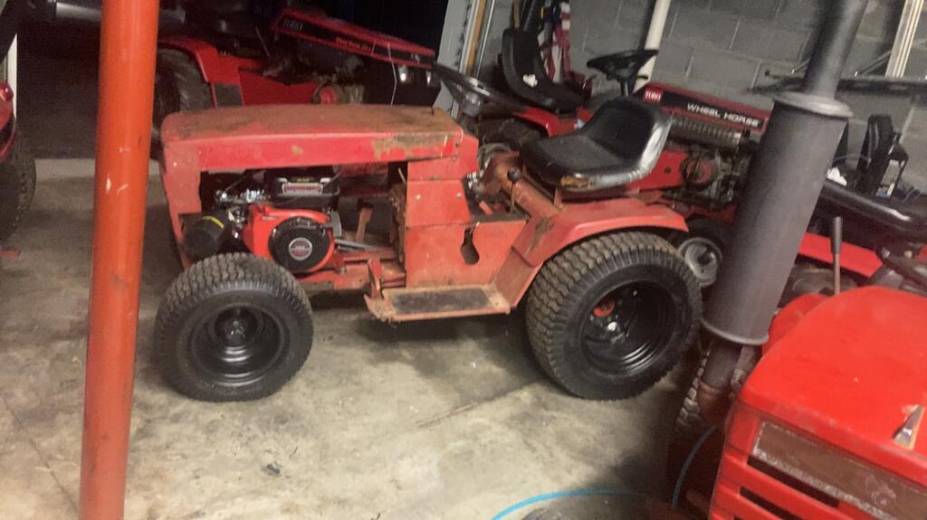

Jake the 312-8 72 #1 Posted November 21, 2023 This is my racing wheel horse it does 20mph and has predator 224 with stage 1 kit 8 2 Share this post Link to post Share on other sites
8ntruck 8,147 #2 Posted November 21, 2023 Is the front axle inverted? If so, how are you holding the spindles in the axle? At 20mph, I hope you are using more than the stock spring clip. 2 1 Share this post Link to post Share on other sites
Jake the 312-8 72 #3 Posted November 21, 2023 Yeah so the axel and spindles are flipped and we drilled holes and put the biggest cotter pin that would fit! 1 1 Share this post Link to post Share on other sites

Jake the 312-8 72 #6 Posted November 22, 2023 Yup every thing built right and tight 1 Share this post Link to post Share on other sites
