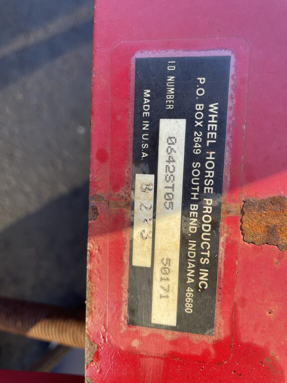

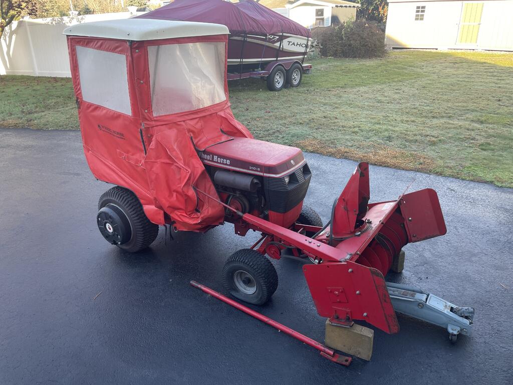

Raven714 6 #1 Posted November 17, 2023 Hey Wheelhorse enthusiasts! 🚜 Exciting news – just snagged a 310-8 with cab and snowblower at an amazing price! 🌨️ It's my second Wheelhorse; my trusty 312-8 has been with me since 1990 with a snow blade. Any tips on attaching the snowblower to the 310-8? The belt seems a bit short for the PTO pulley, and I'm wondering if it's a good fit (model 50171). Any advice would be super appreciated! 🛠️ Thanks, y'all! 1 Share this post Link to post Share on other sites

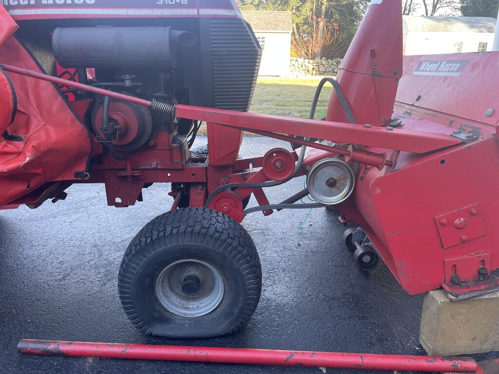

Achto 31,135 #5 Posted November 17, 2023 3 hours ago, Raven714 said: You need to connect the belt to the engine PTO pulley 1 Share this post Link to post Share on other sites
squonk 45,638 #6 Posted November 17, 2023 Belt fits this a way! 3 2 Share this post Link to post Share on other sites
Ed Kennell 45,054 #7 Posted November 17, 2023 to the @Raven714 Use Mike's picture to route the belt. Leave the belt on the blower and vee idler as in your picture and put the belt above the flat idler pulley. Then put the belt on the inside PTO pulley. Then use a 2X4 over the front axle to pry up the Vee idler pulley until you can hook the belt over the flat idler pulley. I don't see the flag that you will need to attach the push rod to the lift lever. 1 1 Share this post Link to post Share on other sites

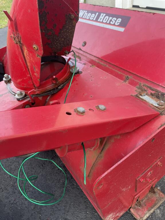

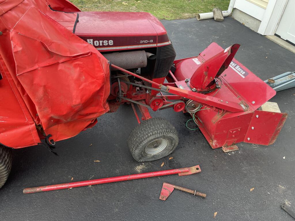

Raven714 6 #8 Posted November 17, 2023 Thanks for the serpentine belt photo, connected to the PTO and works great. have the flag, trying to determine where that goes and how the bar underneath connects. Has anyone ever connected a small winch to the tractor for easier lifting? Also, the snow chute only had a wire cable connected to the turn handle which would only allow the chute to move in one direction? I would think it would be similar to a push snowblower, allow it to move both ways. I really appreciate your help on this. 2 Share this post Link to post Share on other sites

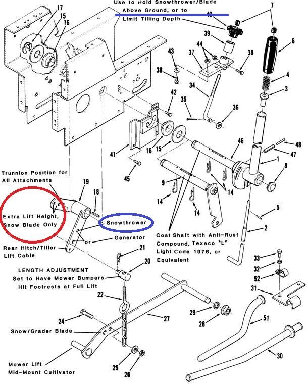

ri702bill 11,420 #9 Posted November 17, 2023 Your flag does not have the angled tab to connect the "Lift Assist" extension spring. I added one on to my NOS 1963 32" snowblower for my 854 - it does help - IF adjusted properly. Later models did come with the tab... Bill Share this post Link to post Share on other sites
Ed Kennell 45,054 #10 Posted November 17, 2023 2 hours ago, Raven714 said: have the flag, trying to determine where that goes The flag is inserted in the open end of the lift tube and the flag pin goes in the hole in the lift lever. Washers/spacers can be inserted on the flag rod to increase the blower lift height. If the wire cable is wound correctly, the chute will rotate from full left to right. Download the manuals for your blower to see these instructions. 1 Share this post Link to post Share on other sites

953 nut 64,340 #14 Posted November 18, 2023 The attachment point for your lift tube is very important, the closer to the pivot the easier it will be to lift, distance above ground can be adjusted too. 1 Share this post Link to post Share on other sites
