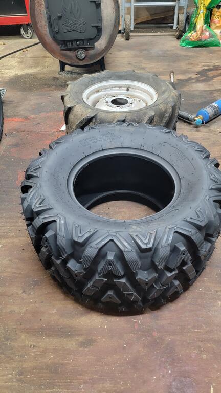

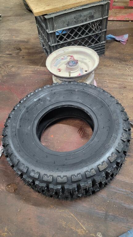

BairleaFarm 344 #51 Posted December 9, 2023 Worried about rim thickness to tire ratio. 🤔 mainly fronts. I think rears will be ok. I know it's hard to tell on smashes tires until you get them mounted. 1 Share this post Link to post Share on other sites

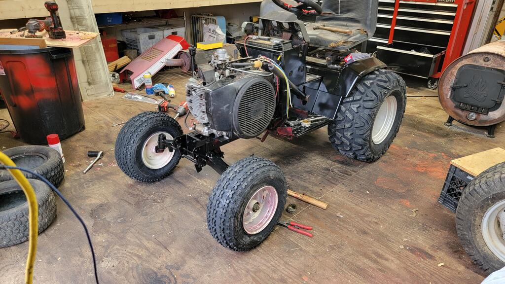

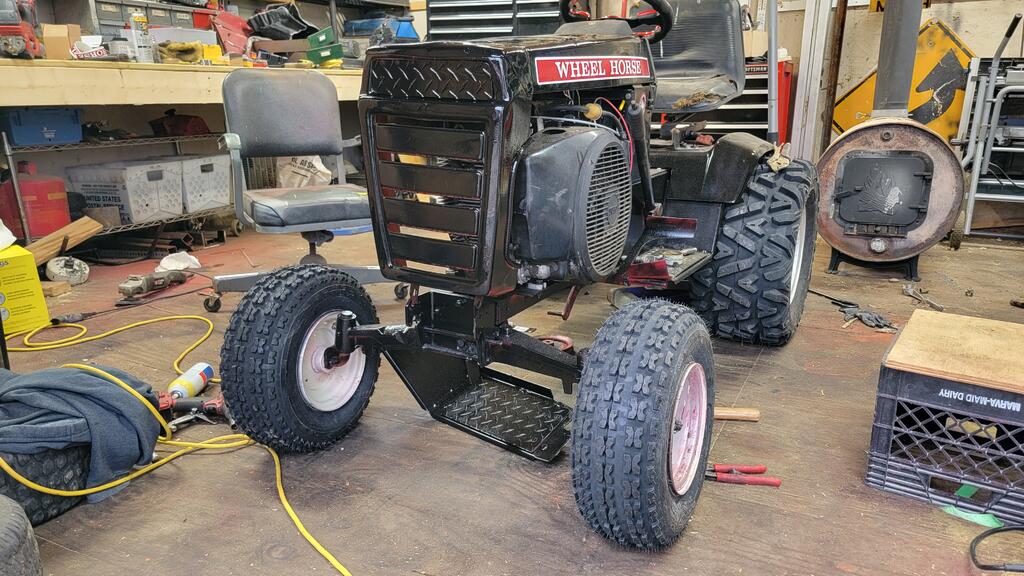

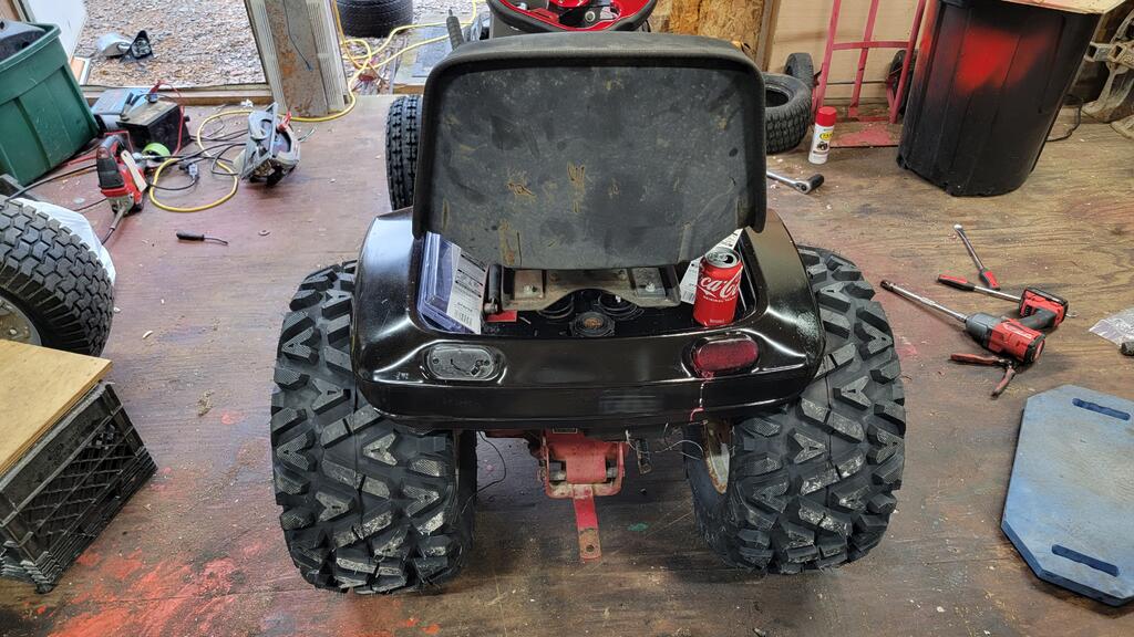

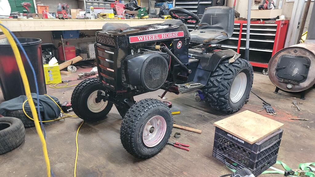

BairleaFarm 344 #53 Posted December 9, 2023 1 hour ago, ebinmaine said: You might be able to get wider front rims from a later model Horse. Or possibly consider a trailer hub conversion. Trailer rims are available 8" or maybe even 10" wide. I'm trying to keep it narrow. I don't like the front axle sticking out wider than the rear. I got them mounted and installed. All in all very happy with the looks. 6 Share this post Link to post Share on other sites
Handy Don 16,179 #54 Posted December 9, 2023 20 minutes ago, BairleaFarm said: I don't like the front axle sticking out wider than the rear. We have Ags on 8.5” rims on the rear of the 518-H++ build which has a swept front using 16x7.50-8 tires. The outside to outside front track is 3+ inches wider. After we have more experience with the performance as it’s set up now, we’ll decide if spacers or wider rears are needed. 1 Share this post Link to post Share on other sites

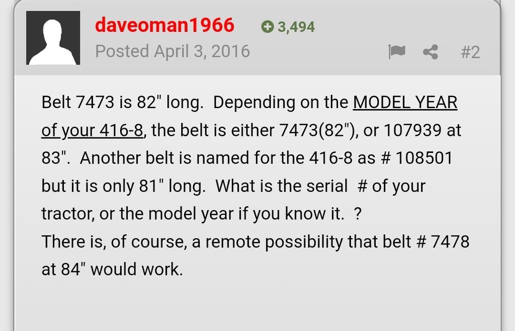

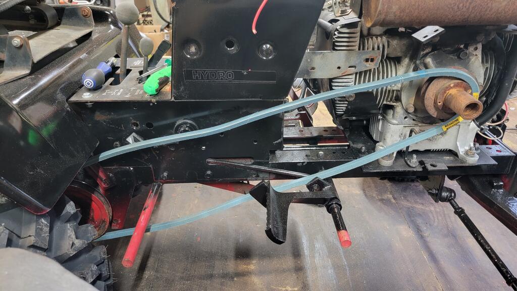

BairleaFarm 344 #55 Posted December 9, 2023 As usual the internet is wrong for my application. 82 and 83" belt are too small 1 Share this post Link to post Share on other sites

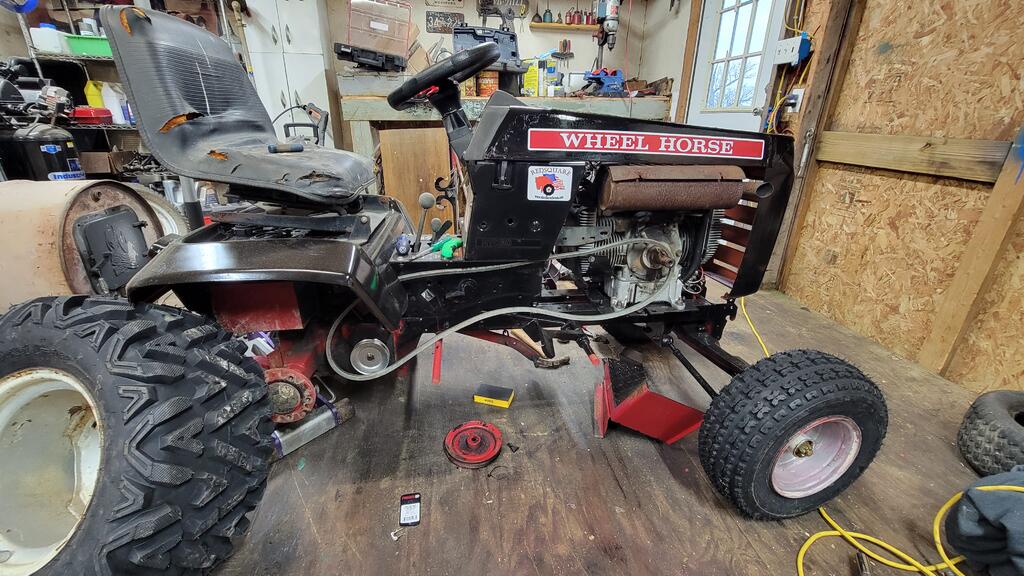

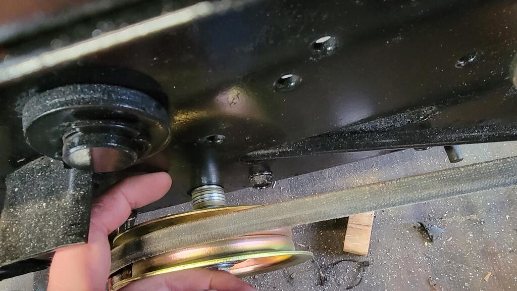

BairleaFarm 344 #56 Posted December 10, 2023 I've got to space the hood hinge up a bit. Since the belt didn't work I decided to go ahead and upgrade the pulleys. They should be here this week. Decals from redoyourhorse 5 Share this post Link to post Share on other sites

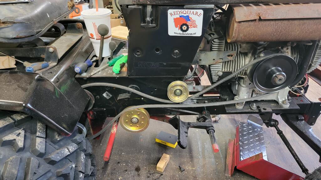

BairleaFarm 344 #57 Posted December 16, 2023 Pulleys lined up and installed. Had to space the idlers out a bit but they are good by straight edge. I'm sick so that's about all I got done today. 3 Share this post Link to post Share on other sites
sjoemie himself 3,106 #58 Posted December 21, 2023 Cool looking horse you've got there. I also like the tire combo. Would you mind putting some pics and info of the tires in the "let's talk tires" topic? 1 Share this post Link to post Share on other sites
kpinnc 17,666 #59 Posted December 22, 2023 On 12/16/2023 at 4:12 PM, BairleaFarm said: Pulleys lined up and installed. Added the same extra flat idler on my 520-H a few years back. Works great! No more flapping belt! 2 Share this post Link to post Share on other sites
ebinmaine 78,072 #60 Posted December 22, 2023 On 12/16/2023 at 4:12 PM, BairleaFarm said: idlers 8 hours ago, kpinnc said: Added the same extra flat idler on my 520-H a few years back. Works great! No more flapping belt! Excellent idea. @BairleaFarm I've saved that post for future reference. Share this post Link to post Share on other sites
