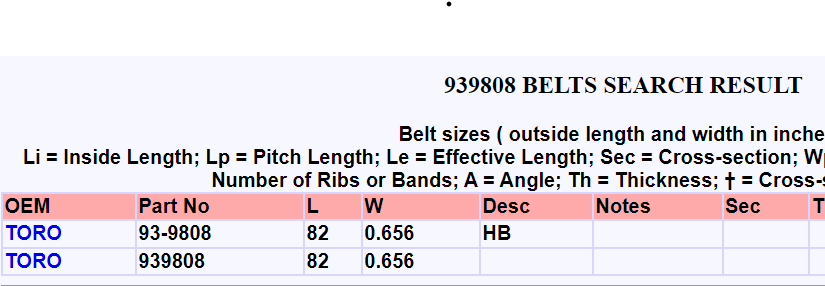

John c 136 #1 Posted November 10, 2023 The transmission has developed a habit now of not completely disengaging, with the clutch all the way in the machine will continue to move on smooth flat level surface, doesn't take much to stop it, but it also keeps the internals in the transmission moving to point the gears won't synchronize smoothly. the belt is 5/8 x 82 and has about 30hrs use on it What do the resident 8 speed gurus think is causing this condition. Share this post Link to post Share on other sites

daveoman1966 3,882 #6 Posted November 10, 2023 Are you using the OEM belt? An after-market belt MAY not have the same geometry. 1 1 Share this post Link to post Share on other sites
ebinmaine 77,507 #7 Posted November 10, 2023 23 minutes ago, daveoman1966 said: Are you using the OEM belt? An after-market belt MAY not have the same geometry. I've had that problem. I now use ONLY Wheelhorse belts on my 70s C series. 1 Share this post Link to post Share on other sites

Racinbob 12,800 #10 Posted November 11, 2023 (edited) 14 hours ago, ebinmaine said: Is a 314-8 one of the rigs with the gas damper for a clutch "spring" and would that being worn cause the OPs issue? @John c Removing safety devices isn't recommended but those darn things were more of a drivability issue than safety. They tried three ways to utilize them. A damper used with the spring, a dampening stop with the spring, and a strut without the spring. I wouldn't be surprised if they tried some other combination along the way as well. Personally I would remove all that crap. Just use a 108035 spring on the left side of the transmission. That set up has safely worked for decades and still does. For tractors that use a 5/8" drive belt I would suggest using an OEM belt. Make sure the pullies are clean and the idler is in good shape. Then make sure the belt guard is in place and the tabs are adjusted properly as mentioned. Your problem should be solved. My first experience with the belt engagement do dads was in 2009 when I purchased my 2005. It only had 100 hours on it and I got it for an unbelievable price because I'm sure the guy didn't know what he had. I got it home and started mowing with it. It would come to a stop just fine but when I went to reengage the drive it had a very annoying delay. I had no clue as to why because I had never heard of those new fangled devices engineered by someone who probably never drove a Wheel Horse. Well, I tore into it and parts started flying. Nuff said. Edited November 11, 2023 by Racinbob 1 2 Share this post Link to post Share on other sites

ebinmaine 77,507 #13 Posted November 12, 2023 16 minutes ago, John c said: OK, I've figure out my issue, in a search for some way to get more belt slack I had removed the belt brake before I even knew it was a brake or fully understood it's purpose. I'm still wanting to come up with a way to disengage the transmission enough to allow the tractor to roll backwards down an incline using just the clutch. My next thought would be to try a longer belt, but how much longer would it need to be to allow for the slack necessary to let it slip in the trans pully, but still within the idler pullys ability to maintain tension enough to not slip under load ? Anybody ever been down this road before with any success BTW.....This machine is '95 model labeled as toro/wheelhorse 314-8, it does have the hyd cylinder clutch dampner spring but that was shot when I got it 10 of so years ago, My thoughts: DO NOT get a longer belt. My experience shows me that's a PITA and does more harm than good. DO get the right WHEELHORSE belt and also replace the hydraulic cylinder with the old style 108035 spring as above. The tractor will likely roll back (or forward) when in neutral if the belt is correct and the system is working as originally designed. Note: There ARE tractors that won't move much or at all when in any gear. Belt stopped or not. Or.. even when the shifter is completely disengaged. My own '74 C160 and Trina's 867 both have very little desire to move when not being driven by the belt unless the grade is headed towards steep. At least if you bring the tractor to a good working proper condition it'll do what it's supposed to... even if it won't roll... 1 Share this post Link to post Share on other sites
