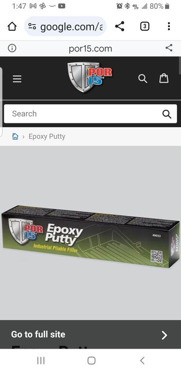

gt14rider 1,291 #29 Posted November 10, 2023 What about 2 part epoxy putty. You can drill and tap it. Here's one kind, but there's a bunch different manufacturers. 2 Share this post Link to post Share on other sites

WHX?? 58,388 #36 Posted November 10, 2023 3 hours ago, gt14rider said: What about 2 part epoxy putty. You can drill and tap it. I tried that stuff once. Called liquid steel. Didn’t work too hot. Drilled & tapped OK but didn't stick very well. Might not have it clean enough. Oil in metal pores? Share this post Link to post Share on other sites
