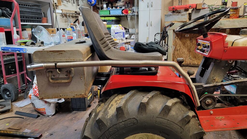

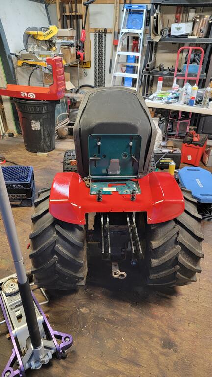

BairleaFarm 344 #26 Posted November 16, 2023 On 11/8/2023 at 5:01 AM, Just getting started said: Yes, my grandson and I are already at the drawing board trying to redesign them as we look for rims. I used unistrut for my 26x12x12. You wouldn't have to cut the seat pan like I did. I did it as I wanted support for a rear rack. Issue with a seat pan raise is your latch won't work. You'll want the latch bar under your raise so you don't have to hardbound the step boards like I did. 2nd picture shows my 3 bolts where the set pan and floor board are mounted solid. 2 Share this post Link to post Share on other sites
