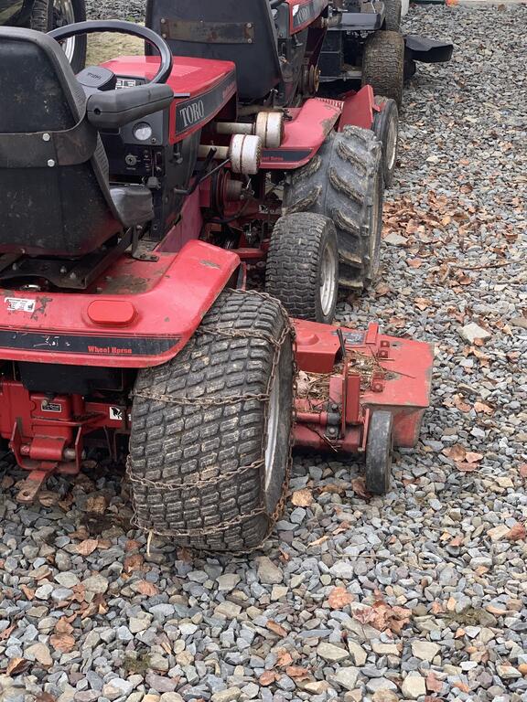

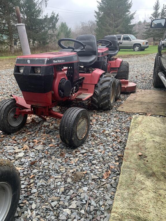

littleredrider 409 #13 Posted November 11, 2023 I have 25x12x12 ATV tires on 10" wide wheels on my 520 diesel, never measured but they fit under the fenders. They are a V-tread type, and the center of the lugs are inline with the edge of the fender. I have pics somewhere here, if not I can get em off my phone. Also, I got the rims/blanks from Miller tire, great stuff!! 2 Share this post Link to post Share on other sites

ebinmaine 77,322 #16 Posted November 12, 2023 23 hours ago, littleredrider said: I have 25x12x12 ATV tires on 10" wide wheels on my 520 diesel, never measured but they fit under the fenders. They are a V-tread type, and the center of the lugs are inline with the edge of the fender I like that look. That's about how my '74 C160 Cinnamon Horse is. Is there a thread or pics of your setup? 1 Share this post Link to post Share on other sites
littleredrider 409 #17 Posted November 12, 2023 I'm not on much anymore. Job, other projects, but I don't have a thread, just posts like this n posted some pics. I'll see if they are still on my phone, and I will post them here. Of not I'll go out n get some.... 1 1 Share this post Link to post Share on other sites
littleredrider 409 #18 Posted November 12, 2023 Guess I still have em lol 1 1 Share this post Link to post Share on other sites

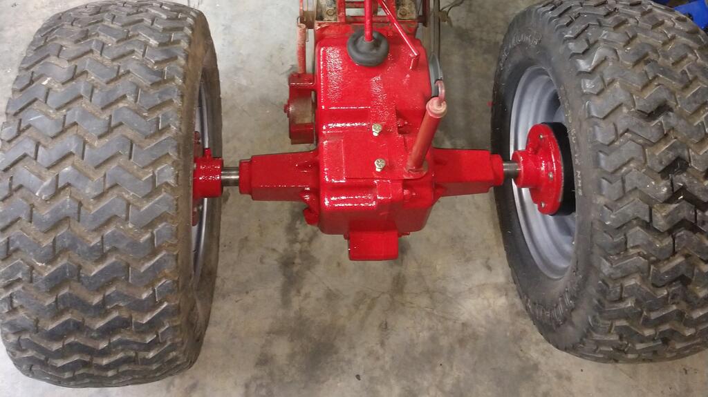

Lee1977 7,551 #21 Posted November 13, 2023 You order what you want. I would not worry about the back set to much as there is plenty of room on a Raider. Here is a picture of my Raider 12 with 25 x 10 x 12 on a 8 1/2" rims with a 3 1/4" back set. 2 Share this post Link to post Share on other sites
