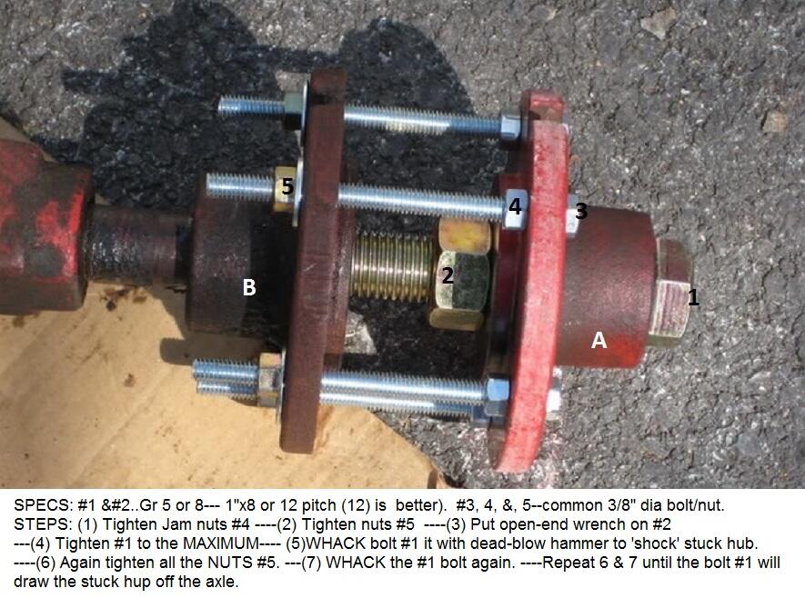

ebinmaine 72,798 #5 Posted November 8, 2023 10 minutes ago, Cjwv1975 said: What puller do you recommend. I know the long finger pullers are frowned upon The one I have is home shop made. I'd recommend doing a good search on the site to see the options. Hydraulic jacks can be even better used with the right set-up. To say the 3 jaw puller is frowned upon is correct... And putting it lightly. The chances are VERY high that will break the hub. Share this post Link to post Share on other sites
daveoman1966 3,841 #6 Posted November 8, 2023 (edited) Go here: https://lookup3.toro.com/partdex/index.cfm?xCaller=Toro&lang=us_en Enter your model # as B-100... clik SEARCH. You see a list of B-100 models. Clik on your MODEL NUMBER...all sorts of schematics will pop up, giving you OEM part numbers for everything. As to the hub: this puller has never fialed me...make it from an old hub and nuts/bolts from any hardware. Edited November 8, 2023 by daveoman1966 4 Share this post Link to post Share on other sites
