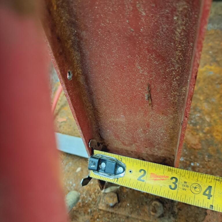

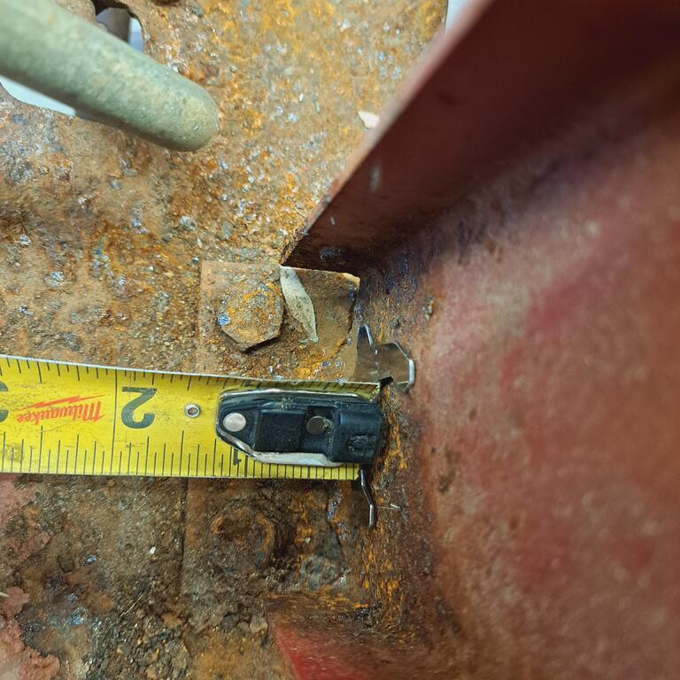

WHX?? 58,308 #76 Posted November 9, 2023 Right ... prolly wouldn't been a problem if not for the danged mice but the support is not very thick ... 18 guage at best may be 16. The front cover doesn't do much as far as support. 3 Share this post Link to post Share on other sites

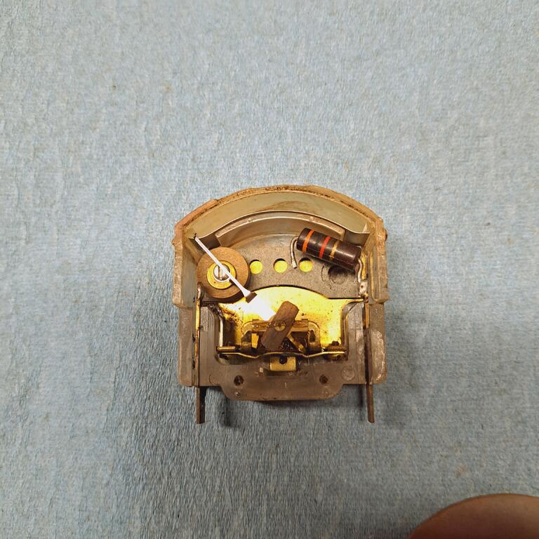

WHX?? 58,308 #79 Posted November 9, 2023 6 minutes ago, Racinbob said: And thus ends this thread................ Not quite Bob ... we have yet to have fun. Took the fuel meter apart Richard just for drill. Now I know you are a old ET back in the day ... tell me what this resistor is in ohms. No cheating and Googling it. Shush up you other clowns... 1 Share this post Link to post Share on other sites
Racinbob 13,223 #80 Posted November 9, 2023 I kinda figured Mrs. WHX might have put you in the ER after that post. I guess she hasn't seen it yet. Oh, the resistor. I had to do the little jingle in my mind again bit if I haven't lost everything and I'm seeing the colors correctly I think it's a 30k ohm 5%. Am I close? 1 1 Share this post Link to post Share on other sites
Achto 32,847 #81 Posted November 9, 2023 9 hours ago, WHX?? said: I'm gonna throw this ball in @Achtos court. I like option "C". Make a bracket out of some 12 or 10ga, can be welded or bolted. Might be able to hide it enough so that it is not noticeable. Maybe trim the bottom of the tower and tuck the bracket in the inside, floor mat will cover what is on the floor? 2 1 Share this post Link to post Share on other sites

WHX?? 58,308 #84 Posted November 9, 2023 1 hour ago, Achto said: I like option "C" I do too. Good job for you when I'm on safari. I'll get you some dims. Yes floor mat ain't much but still usable and would cover it. 1 Share this post Link to post Share on other sites
953 nut 69,899 #85 Posted November 9, 2023 9 hours ago, WHX?? said: Richard just for drill. Now I know you are a old ET back in the day ... tell me what this resistor is in ohms. I just got up and fed the cats and you are asking me something like this Let me have a cup of coffee and think about this, It has been sixty years since I went through ET school but I remember the Mnemonic that was used for the resistor color code. Bad Boys R@pe Our Young Girls But Violet Goes Willingly Get Some Now! Bad BLACK 0 Boys BROWN 1 R@pe RED 2 Our ORANGE 3 Young YELLOW 4 Girls GREEN 5 But BLUE 6 Violet VIOLET 7 Goes GRAY 8 Willingly WHITE 9 Get GOLD 5% Some SILVER 10% Now NONE 20% Soooooooooooooooo, doing the math we have ORANGE = 3, BLACK + 0, ORANGE = 3K, and GOLD = 5% becomes 30,000 ohms +/- 5% Bob wins the prize what is the prize? 2 Share this post Link to post Share on other sites
WHX?? 58,308 #86 Posted November 9, 2023 Excellent Richard... the coffee cup & chart is extra credit you get an A. 34 minutes ago, 953 nut said: Bob wins the prize what is the prize? Bob gets a C- for raising his hand out of turn. His prize is getting to work on your tractor! 2 Share this post Link to post Share on other sites

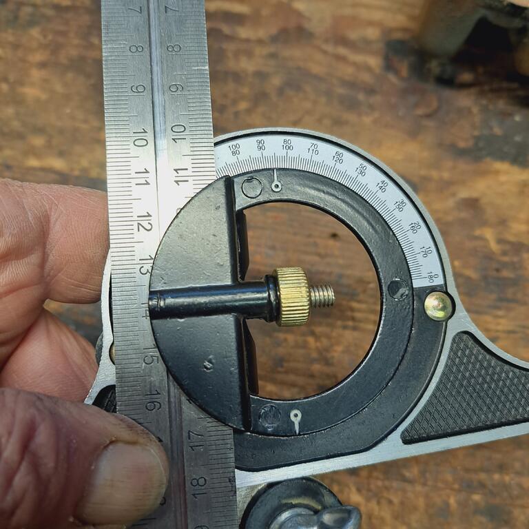

WHX?? 58,308 #87 Posted November 9, 2023 (edited) Here we go Dan. I think a guy should go in with a cut off wheel and remove the rusted cracked piece. L bracket can go to the inside and face forward. The two bolts can hold it down & a couple of bolts to the support. A center triangle gusset is optional but not required. The cover holds it from moving front to back. Bodda bing bodda boom done. Support can cover the whole thing after Richard finds one of those cool light kits NOS. Angle is 85 deg. Edited November 9, 2023 by WHX?? 1 3 Share this post Link to post Share on other sites

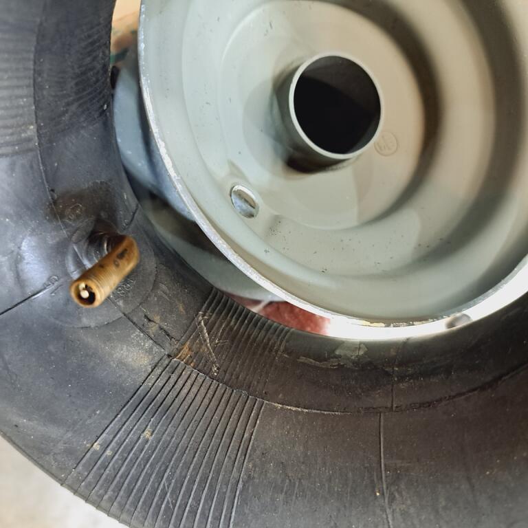

WHX?? 58,308 #91 Posted November 9, 2023 (edited) Tubes for the front came in today too. And I quote On 11/6/2023 at 5:33 PM, WHX?? said: Standard TR13 valve stems on the tubes. Wrong stems... these won't work ...TR87 stems for when the hole is in the middle of the rim. We can run them tubeless ... your call Richard. We would need something to the order of THESE Edited November 9, 2023 by WHX?? 2 Share this post Link to post Share on other sites
953 nut 69,899 #92 Posted November 10, 2023 2 hours ago, WHX?? said: Tubes for the front came in today too. And I quote On 11/6/2023 at 6:33 PM, WHX?? said: Standard TR13 valve stems on the tubes. Wrong stems... these won't work ...TR87 stems for when the hole is in the middle of the rim. My bad. Got the correct ones coming your way, should be there when you get back from the safatie. 2 1 Share this post Link to post Share on other sites

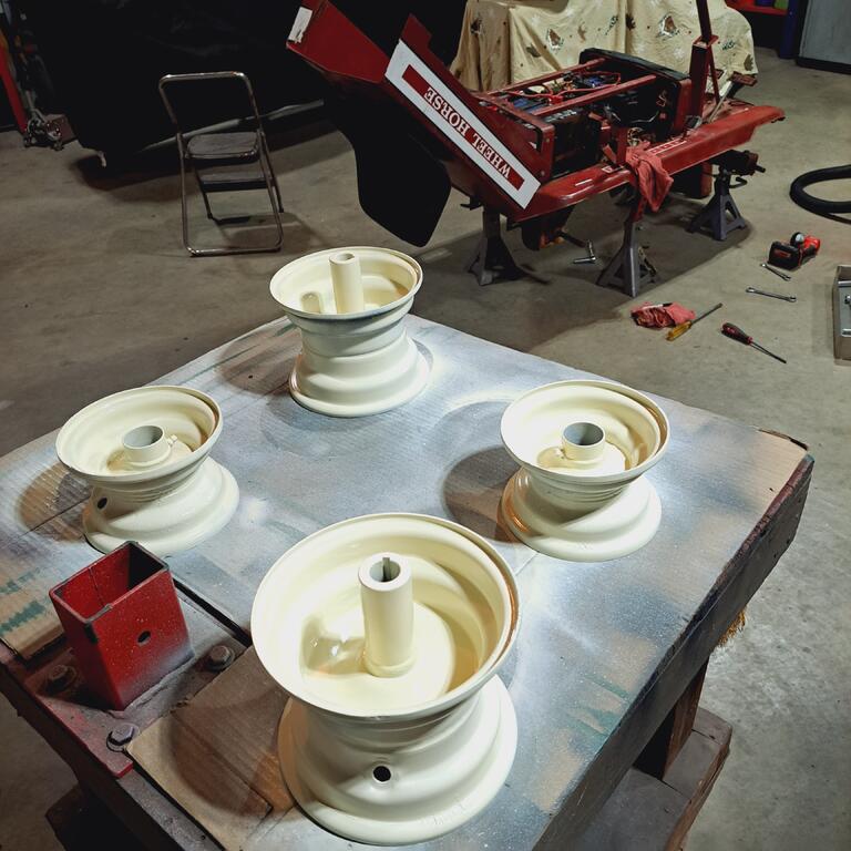

WHX?? 58,308 #93 Posted November 10, 2023 1 hour ago, 953 nut said: safatie You want to try and return these? Done the same thing many times when ordering. Ordered deck bearings and didn’t double check the numbers. Good thing they weren't high ticket items. Paint drying on rims as we speak. 4 Share this post Link to post Share on other sites

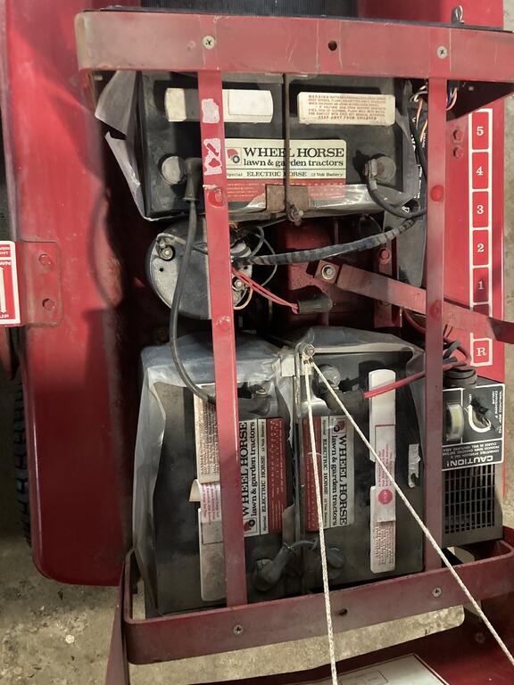

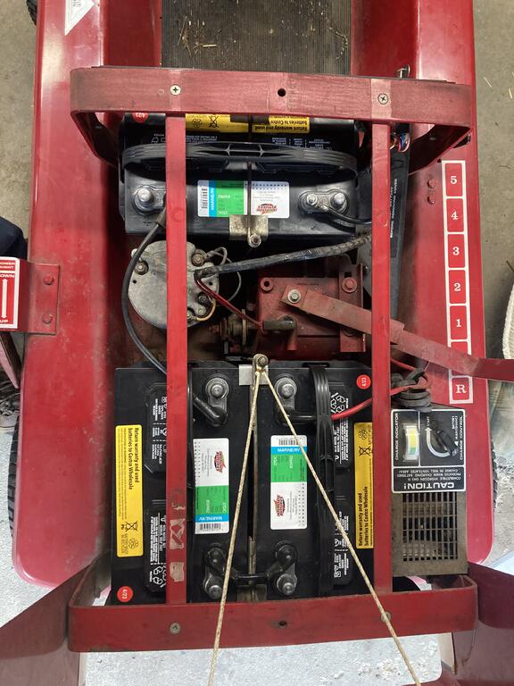

uglyblue66 134 #95 Posted November 13, 2023 where did you git the tires from? My A-60 will need 2 fronts , and i think i only have 1 5 inch rim ,i may have to cheat and use some 4 inch rims I have handy until the chance comes to find a 5 inch 1. Thanks for this thread as it will help me alot to get my A-60 going being able to come to this thread and look at pics. The deck scatter shield thingy is gone off my deck. My plastic control panel is also gone. which means regardless of how well i get the rest of the machine fixed up, my dash will be metal and not "right". but not many of these around so maybe I can park a few machines down from 1 that might happen to show up where i am!. So am I reading this right that the batterys in this machine are like group 27 size or so? my Elec traks use batterys that are group 24 size cases. Share this post Link to post Share on other sites
SylvanLakeWH 32,722 #96 Posted November 13, 2023 8 hours ago, uglyblue66 said: where did you git the tires from? My A-60 will need 2 fronts , and i think i only have 1 5 inch rim ,i may have to cheat and use some 4 inch rims I have handy until the chance comes to find a 5 inch 1. Thanks for this thread as it will help me alot to get my A-60 going being able to come to this thread and look at pics. The deck scatter shield thingy is gone off my deck. My plastic control panel is also gone. which means regardless of how well i get the rest of the machine fixed up, my dash will be metal and not "right". but not many of these around so maybe I can park a few machines down from 1 that might happen to show up where i am!. So am I reading this right that the batterys in this machine are like group 27 size or so? my Elec traks use batterys that are group 24 size cases. Let me know if you need any measurements or pics. Mine is complete and factory correct. Here are the marine batteries i put in (Costco) and the NOS ones that came with it. Yes 27. 2 Share this post Link to post Share on other sites

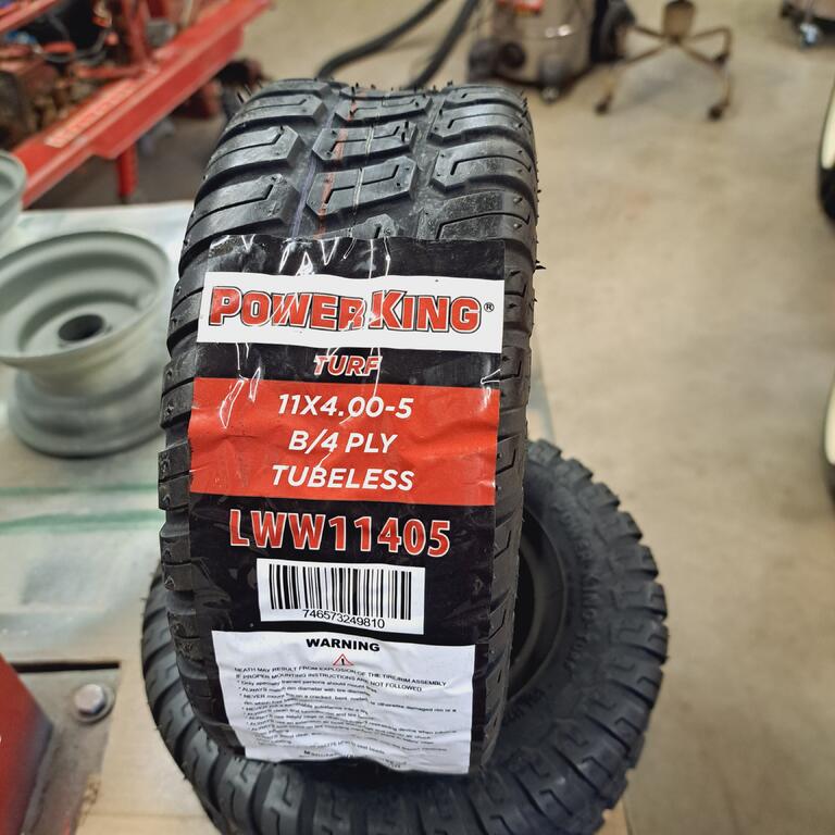

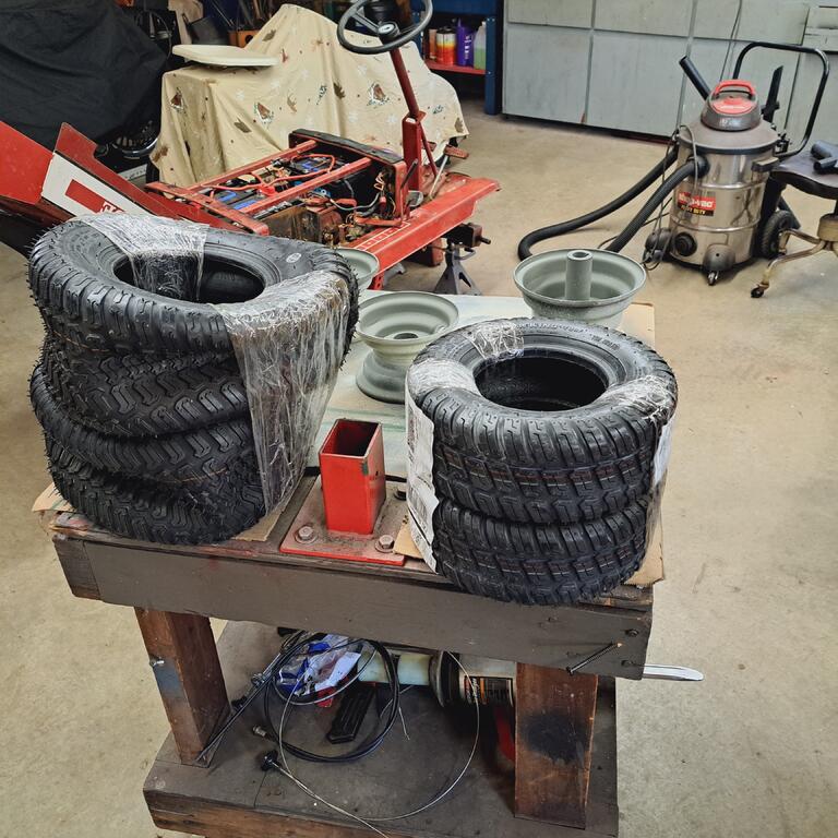

953 nut 69,899 #97 Posted November 13, 2023 14 hours ago, uglyblue66 said: tires Here is a link to the tire dealer I used. Ebay has several sellers also but by the time you price the tires and shipping from GIGA i8t is the same as the Ebay "free shipping" sellers. https://www.giga-tires.com/15-6.00-6/power-king-tires/turf/tirecode/LWW25 1 Share this post Link to post Share on other sites
WHX?? 58,308 #98 Posted November 13, 2023 I can vouch for the quality. Orginals are 2 ply these are 4. Very stiff sidewalls. Gonna be fun to mount. 2 Share this post Link to post Share on other sites
uglyblue66 134 #99 Posted November 15, 2023 well I have 3 group 27 agm batterys that I could use in the A-60! that is GOOD news! didn't know they would fit in there as my other electric machines will only accept 24's. 2 Share this post Link to post Share on other sites
