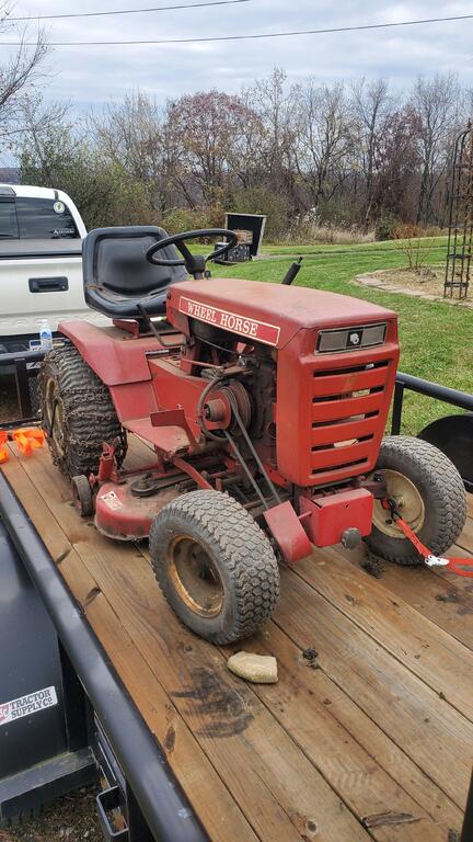

Cjwv1975 117 #1 Posted November 5, 2023 Picked up a 76 B100 today. First WH. Doesnt run but my best friend said it did and something electical is wrong and he never had time to mess with it. Said it ran strong when it did. Best part it was free! 7 1 Share this post Link to post Share on other sites
kpinnc 15,953 #2 Posted November 5, 2023 2 hours ago, Cjwv1975 said: Best part it was free! Free is awesome! Looks like a solid machine. Get her running and enjoy! 2 Share this post Link to post Share on other sites
oliver2-44 11,026 #3 Posted November 5, 2023 As you get familiar with it, the left rear rim looks like it has an oil coating like the rear seal is leaking. One of our vendors Wheel Horse Parts and More has the seals. Pulling the hubs can be a challenge. Don’t use a 3 jaw puller, it will break the hub. Come back to the forum for more details. 4 Share this post Link to post Share on other sites
Retired Wrencher 6,109 #5 Posted November 5, 2023 (edited) Like Oliver2-44 said be care full with the hubs. You can damage inside of the tranny with to much force.I always thought if it is leaking or wet at the end of the axel meaning at the end it is an easy fix. But if have to find a torch to heat it up. Not map gas. This is not hot enuff. Edited November 5, 2023 by Retired Wrencher 2 Share this post Link to post Share on other sites

Cjwv1975 117 #8 Posted November 5, 2023 Thanks everyone. First I am going to clean it up and get it running. Parking brake doesnt work but it looks like a spring is broke on it. Than address rear axle seal and rewire it. Thanks for the replies. Share this post Link to post Share on other sites
