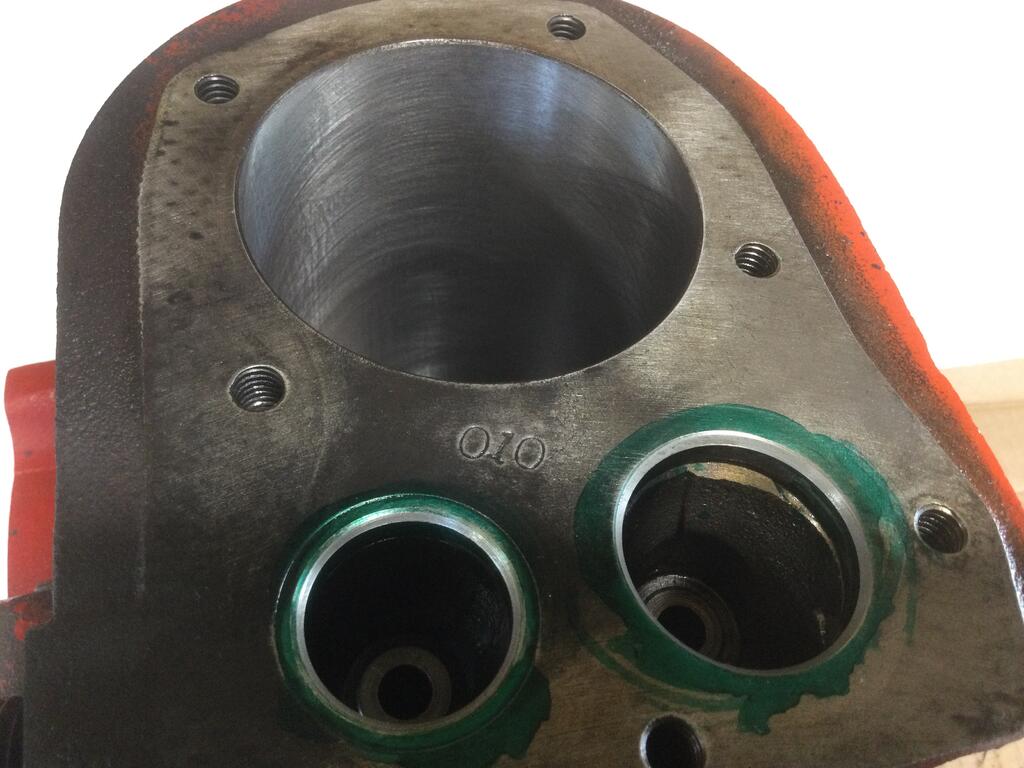

Tuneup 1,459 #31 Posted November 5, 2023 30 minutes ago, CCW said: After speaking with the nearby option he let me know that the machine shops really do not want these tiny jobs. He has had blocks sit in their shop for months before they did anything. He is happy to do the job but has been frustrated by the machine shop. I had to take my K301 an hour and a half away to get to a shop - out next to Road Atlanta. He gave the same story - was too busy and would take almost a year to get to it (to turn me off). I told him I had it to the bare block and he said to bring it right in. Still, took 10 days and another 3 hours on the road but she's sweet for that .020 and $150. Oh, story on Snapper. My old - on its 3rd engine out of someone's trash, 86 Snapper Hi-Vac push is getting to be a bit much at my 61 years and 3/4 of an acre of Bermuda every 4 days so went to look at their page and decided I'd drop the dime on their auto-push machine. They are no where to be found. My old dealer in Douglasville where I got my '99 rider said maybe someday. Finally a dealer in Adairsville gave the story: when you call to order, the distributor model was found to have changed. You can't order this or that tractor or mower like in the past. You have to order a standard lot so, if you want 5 push mowers, you have to get 3 Z turns and other stuff "that I don't want". People just stopped ordering and many dropped the brand. I went with the Toro from Home Crappo delivered to my door and am very happy, thus far, with it and its little Briggs. The Snapper rider 11HP is a grass vacuum and the little 86 will be restored for the kids. 1 Share this post Link to post Share on other sites
