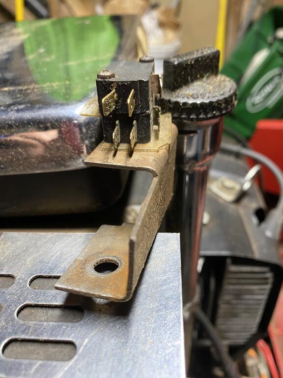

Allen Keith 2 #1 Posted October 30, 2023 Could someone please tell me the correct wiring for this switch. I have a wheel horse 520h. I believe it is an 89. The wiring schematic is showing the same color wires that is on it but I still can’t figure it out! A closeup pic would help Share this post Link to post Share on other sites
gwest_ca-(File Mod) 11,984 #2 Posted October 31, 2023 Two 111332 switches stacked. One controls the ignition and the other controls the starter. 1 Share this post Link to post Share on other sites

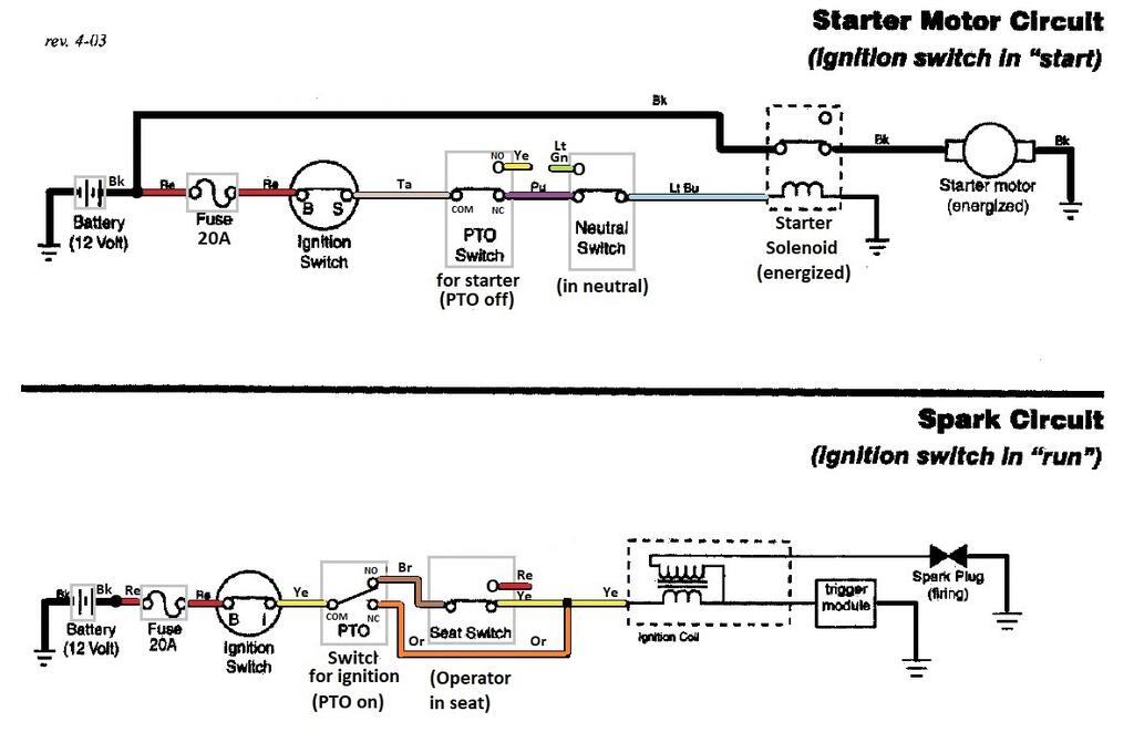

gwest_ca-(File Mod) 11,984 #3 Posted October 31, 2023 If you download the 2nd file it will make more sense. Each circuit has it's own diagram. Ignition Yellow goes to COM (Common) - This yellow goes to ignition switch (I) terminal Orange goes to NC (Normally closed) Brown goes to NO (Normally open) Starter Tan goes to COM Purple goes to NC Yellow goes to NO - This yellow goes to idiot lights 1 Share this post Link to post Share on other sites
Allen Keith 2 #4 Posted October 31, 2023 Thank you for the response to my question! That was fool proof even for me to understand and I am up and running again. 2 Share this post Link to post Share on other sites
gwest_ca-(File Mod) 11,984 #5 Posted October 31, 2023 Great Discovered another mistake in the original drawings. The pto on illustration was incorrect. 1 Share this post Link to post Share on other sites
