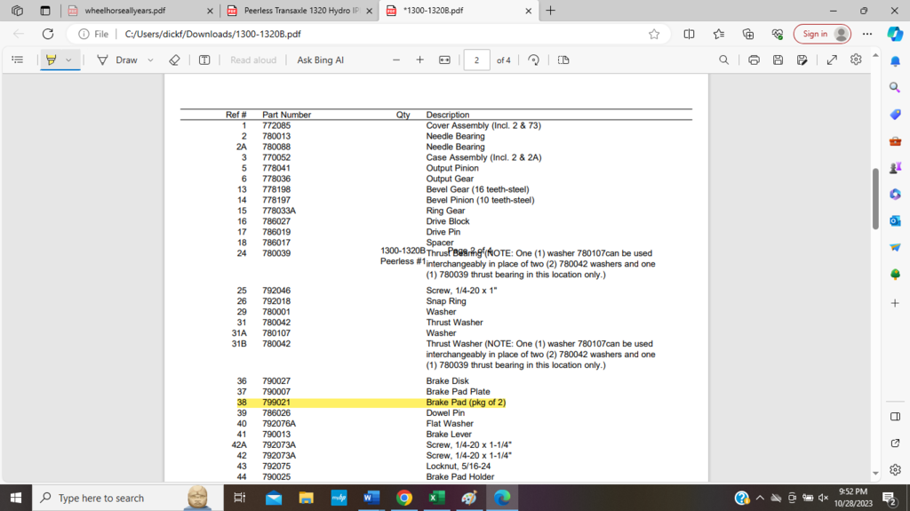

NMWH89-252-H 2 #1 Posted October 29, 2023 Does anyone know the part # and where to purchase - brake pads for WH model 252-H (purchased in 1989)? 1 Share this post Link to post Share on other sites

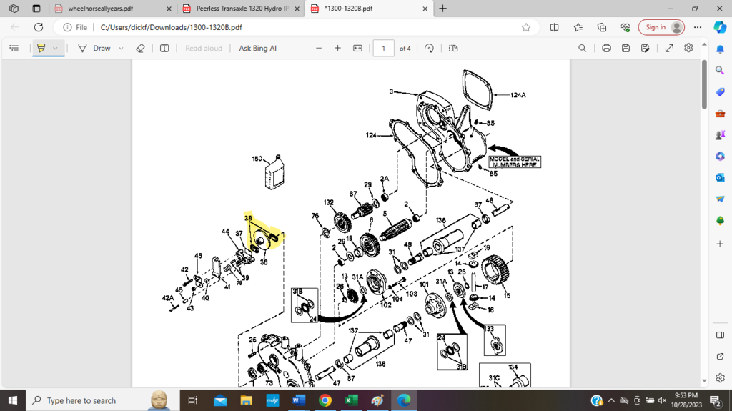

gwest_ca-(File Mod) 12,012 #2 Posted October 29, 2023 Item 38 are the brake pads 1 Share this post Link to post Share on other sites
953 nut 64,263 #3 Posted October 29, 2023 Any of these should stop you in your tracks. https://www.google.com/search?q=peerless+799021&sca_esv=577520305&rlz=1C1JZAP_enUS981US981&sxsrf=AM9HkKlcPf5qv-P_hmKP0Ll-0o2DHD1fRg%3A1698543530585&ei=qrc9Za-eI9arqtsPmtWIwAY&ved=0ahUKEwivm5rej5qCAxXWlWoFHZoqAmgQ4dUDCBA&oq=peerless+799021&gs_lp=Egxnd3Mtd2l6LXNlcnAiD3BlZXJsZXNzIDc5OTAyMTIIEAAYiQUYogQyBRAAGKIEMgUQABiiBEiVtQFQ_A5Yn3hwAXgAkAEAmAHTDqABxZQBqgEKNS0xLjEyLjMuM7gBDMgBAPgBAcICCBAAGKIEGLADwgILEAAYiQUYogQYsAPCAgQQIxgnwgIIEAAYigUYkQLCAgoQABiABBgUGIcCwgILEAAYgAQYsQMYgwHCAhEQLhiKBRixAxiDARjHARjRA8ICBRAAGIAEwgIIEC4YgAQY5QTCAgYQABgWGB7CAggQABiKBRiGA8ICBRAhGKAB4gMEGAEgQYgGAZAGAw&sclient=gws-wiz-serp 1 Share this post Link to post Share on other sites
